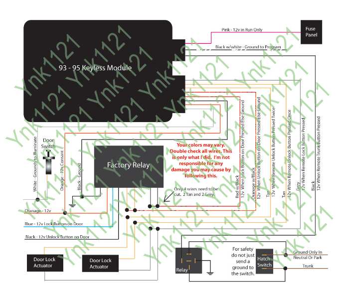

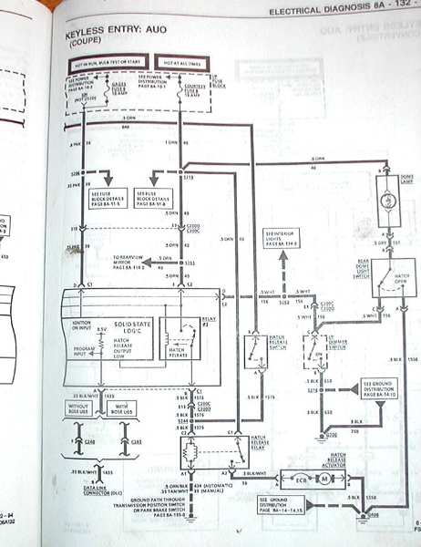

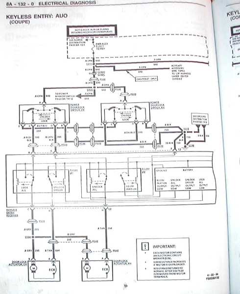

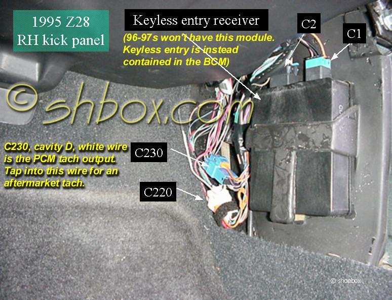

Pics I gathered in case the links above ever go dead

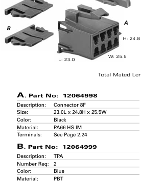

And this one is for the connectors to note which is connector one and two

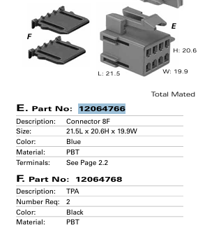

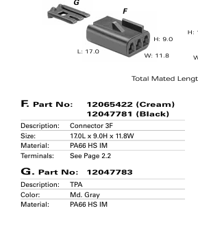

Metric-pack 150 connector:                                    Metri-pack 280 Connector:
And depending on the year of the harness, this metri-pack 150:
I am not sure what years have that connector but I know for sure 84-86ish use a molex connector and 88- at least 91 will use that 3 terminal metri-pack 150.
