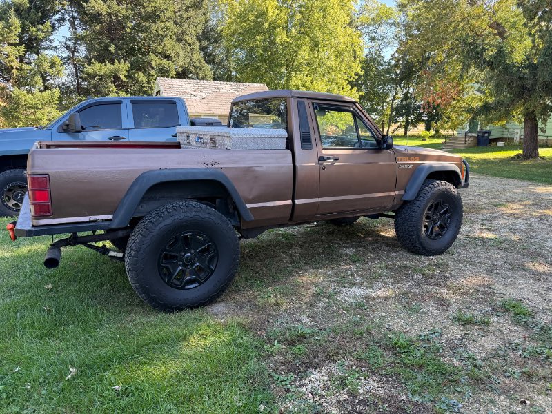

So I took a break from that headache and started fitting some rear tj flares to the truck to make it look way better. Still have to do the passenger side. 2F7D4CA5-7601-457B-94DF-617B895AE456.jpeg.e0a627110f9b70168a1f4cd056d68972.jpeg37949526-0DFB-4429-A623-31F03DD74433.jpeg.b408dca4d0dfc00770e0157ca72a11ba.jpeg5542B440-83C1-4972-B851-FA155318FB12.jpeg.15fc9930a1408162cc5e015cb30ff4b5.jpeg

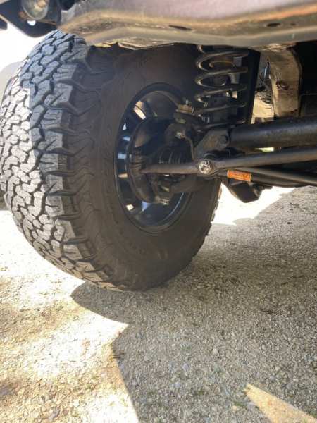

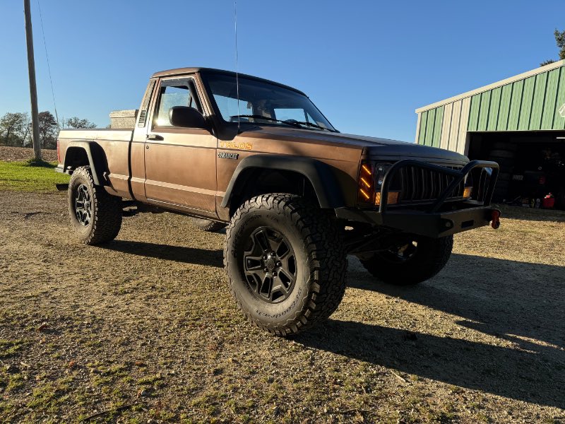

I did finally install the wheels and tires I intended for this. Willys jk wheels and some ko2 315s1B61F3C4-CBDE-4134-BA3D-E15E0DF5646C.jpeg.0ed5037cadb6fe8cbc5e99820c87f93c.jpeg3ED8F931-25D5-4D18-9743-47D4578A5D51.jpeg.ac51b8ddb5eb429095c6b3ef9e054bf0.jpegCB43EFE0-9C0E-4E16-93E4-51D48100D1DE.jpeg.d4a835a8bcea502ef7aa335a44844a43.jpeg5178AD85-1D13-4201-ACA2-3B9C74E95910.jpeg.46da30a74b7ac1759b5c77962b1bae89.jpeg

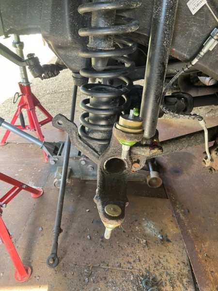

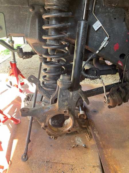

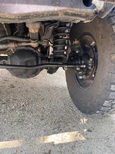

Recently had to rebuild the front end due to terrible death wobble when I tried to adjust the alignment properly and found out all my balljoints were shot.
I ended up replacing all the balljoints, axle shafts with cv style, and v8 zj tierod upgrade.
found out most of my hub bolts were junk, had to weld nuts to two of them, so I replaced those as well. 3F9C7B5F-D8CB-47A4-B65F-E9BC7E8C3605.jpeg.fe447d0bff707593d18aa8b67e2ada86.jpeg72E40318-C37A-4BF3-805B-4587C1CF85E0.jpeg.fcea4789c53736a595c32869be729b33.jpeg775C021C-57DD-4EDF-BC3D-1E3626AE56C4.jpeg.ce73b0a964036eb8aa753cd206620c5c.jpeg2075C5C1-DD3B-4BBD-BF3F-8114979ADF31.jpeg.71de3a7dbf31c6c350769f705d7bcde9.jpeg

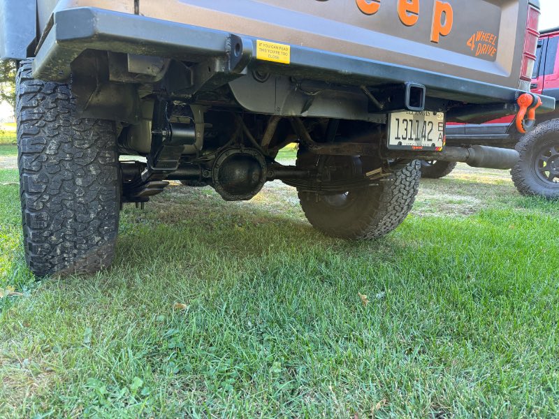

Installed my new heavy load leaf packs awhile ago. It raised the truck atleast 2”

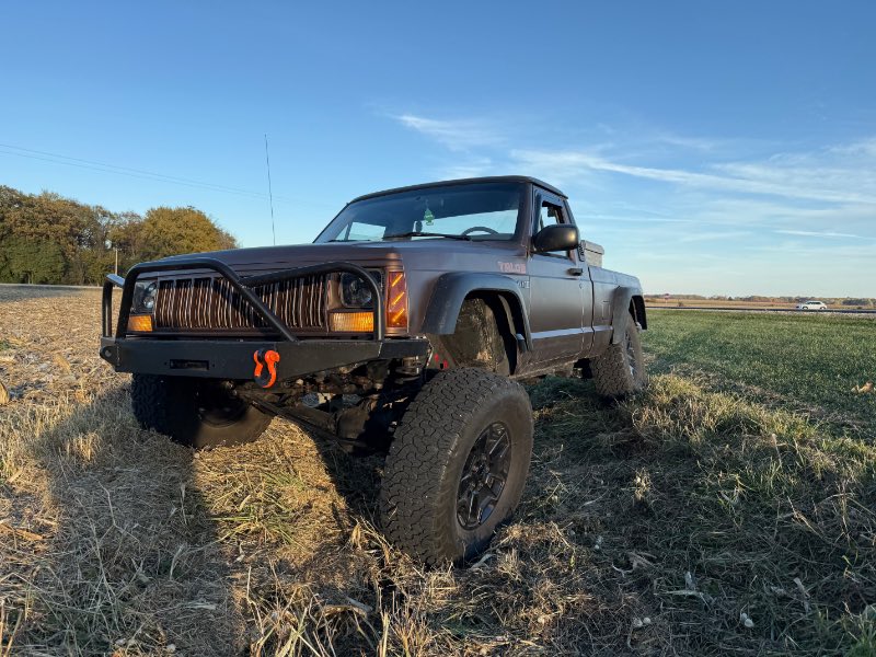

I had some used tubular upper and lower arms as well as some control arm drop brackets I got from a friend when I bought his 92 mj shell. So I installed all of those and a coil spacer to level out the truck and improve the ride. Definitely need all new shocks at some point to make it ride even better. I flexed it out for the first time in a ditch by my home. This is around 4” of lift and 35s
