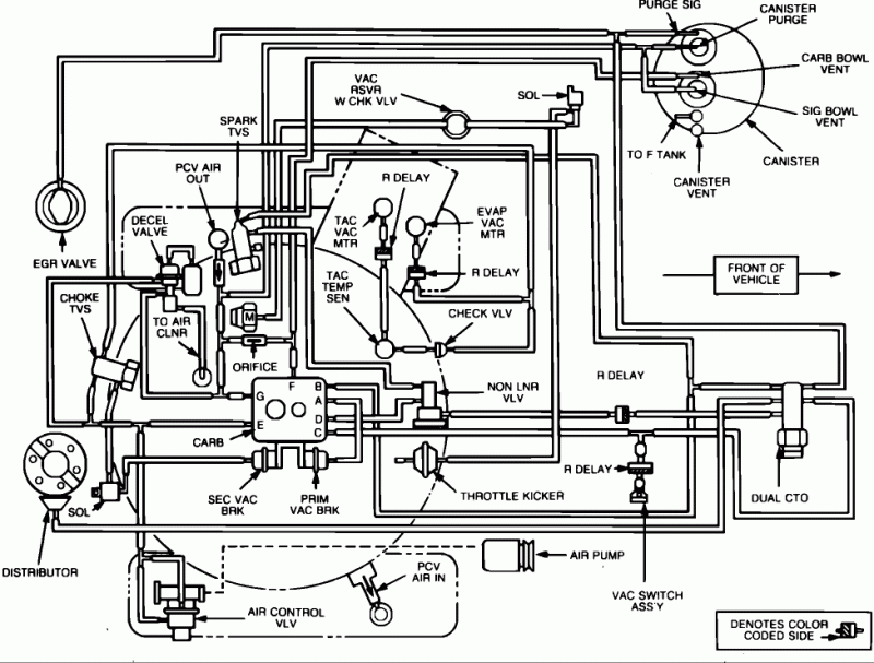

Green Mesa XJ Posted November 8, 2017 Share Posted November 8, 2017 holy crap there's still a supplier for that part! Far as where it goes this diagram of the lines should help, you can see there's is a lot of crap you don't need really. There is a way to make you own canister too. I'll post the link if I find it. I'm also going to try to attach the PDF of the Weber k490 instructions, I think you must be missing them from your kit. The instructions are available freely online from the manufacture so I hope it is not problem adding it. If it is I'll delete it immediately. . Page 3 described the location of the lines and purpose for the original carburetor. Page 4 has the step by step on which lines to use and how to attach them to the Weber 38, page 7 & 8 have images of Weber carburetors Weber WK490.pdf Link to comment Share on other sites More sharing options...

AMC86Kid Posted November 8, 2017 Author Share Posted November 8, 2017 in the diagram picture you posted the arrow that points to (PURGE SIG) is that the bottom port and (CANISTER PURGE) is the top skinner port also the throttle and tranny cables on the carb how do you have yours connected ? is yours a automatic tranny like mine? Link to comment Share on other sites More sharing options...
