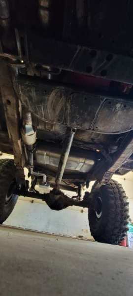

Exhaust get a redemption, it touched everything, floorboards and x members. Mostly 2.75" and I heat wrapped as much of it as I could a while ago.
This time I stuck to mostly factory replacement parts (all 2.5")with some modifying and no wrap.
Old setup with 2 straight through mufflers (2nd one got re used into current setup)
Walker exhaust pieces 95xj down pipe
longbed mj tailpipe the got cut down and angles changed
Prior through muffler gets a little armor gusset to hopefully glide over objects if they become and issue

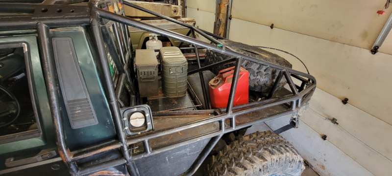

Extra fuel gets a dedicated mount outside of the gas tank basket

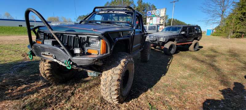

Here we are again!

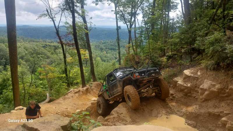

took a trip down to Windrock TN for a weekend of thrills and it did NOT disappoint!
The environment had me harnessed up nice and tight as it in no way compares to the flat lands of Michigan wheeling!
absolutely phenomenal views and climbs!

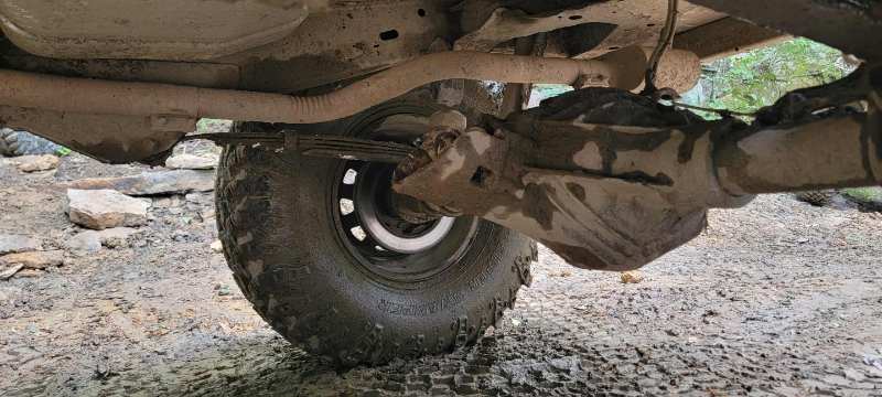

This however led me into a level of wheeling aggression i had not yet unlocked and with the welcomed Rev limiter and bump stop bouncing action i landed myself at the very end of the trip with a familiar sight

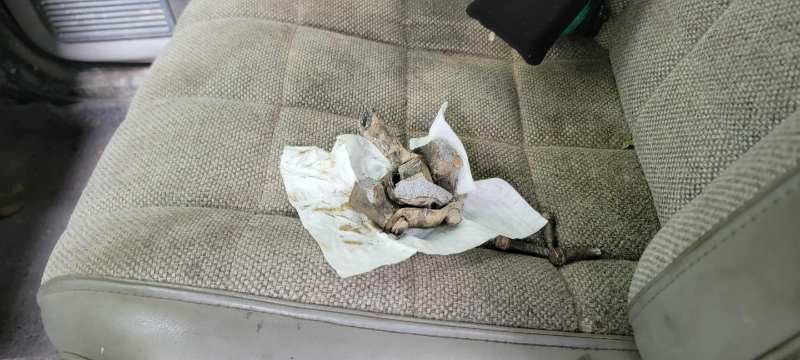

An absolutely destroyed rear pinion yoke and yet again another set of over wrapped leaf springs.
With this also came the realization of how unprepared i was for the trip, having forgotten my tree savers, bulk of actual trail tools and storage ability, i had to rely on my friends more than i had liked to.
Some changes are in order!
The immediate tasks are to fix my leaf springs, pinion yoke and unfortunately the brand new rear driveshaft needs a new 1350 slip end (the yoke destruction also came with the caps launching through the snap ring groves).
