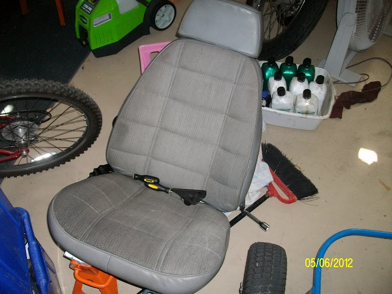

Alright I have the seats in, radiator changed, switched over to open cooling using my washer bottle as the overflow bottle. Also changed the water pump and t-stat while I was at it.

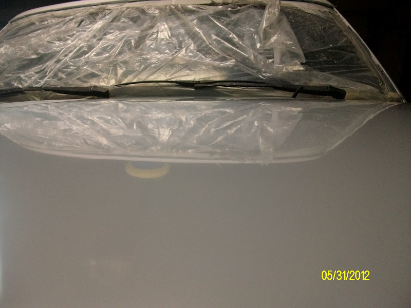

Hung the passenger fender and the hood. Polished out everything on this side. There are a few thin spots on the door so I am going to hit it again with the spray gun when I do the bed. Otherwise it looks pretty good. There are some nasty flaws that I will eventually sand out and fix though...
And a picture showing the paint. Its kind of a lie though. looks great in the picture and looks alright in real life. I am satisfied but the picture does make it look better than it really is. For instance look at the reflection of the roof and realise its not exactly straight... Of course everything looks worse under flourescents so I will see what it looks like outside probably Monday or Tuesday...
