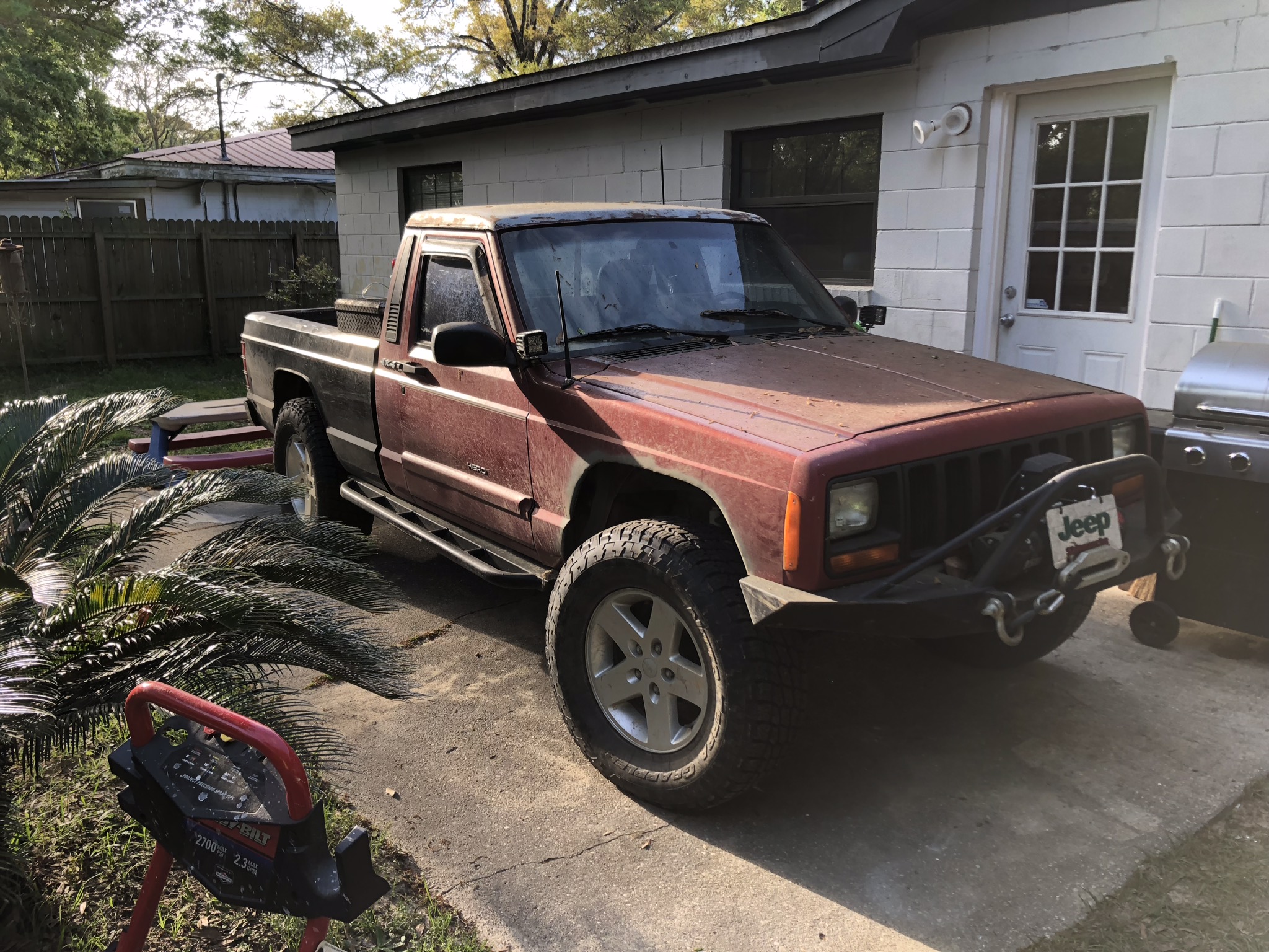

$125 MJ - Project 99 Cheromanche
bucketheadben replied to bucketheadben's topic in Member Projects: Your Comanches
The MJ's wheels are turning under it's own power again. I've got the mj fuel tank in it's stock location thanks to a few guys here on the forum. viewtopic.php?f=2&t=14996 Now that it's been running, I was able to charge up the a/c and freeze out that little cab. :D I've got a few things left on the list before I can start driving it. Then comes the fun stuff. I can't make up my mind, 33's or 35's? -

I've swapped the entire drivetrain from my 99XJ into my MJ, now I have to figure out how to get fuel to it. Id really like to keep the tank in the stock MJ location, but he XJ tank will not fit naturally. So I'm wandering if anyone knows the measurements of a TJ or Grand Cherokee gas tank. Maybe one of those will fit. Or if there is no other option, I'll put a fuel cell in the bed. Has anybody been faced with this issue or have any ideas. Thanks Ben

Well I got off of my lazy butt an took some more pics as it sits. Image Not Found Image Not Found It now moves under it's own power, but is still along way from being street legal. My biggest problem will be trying to figure out what to do with this gas tank. Image Not Found Once the tank is finish I'll be on the downhill slope. All that's left is little odds and ends like welding up seat brakets so i can finish the interior, installing a rear sliding window, e'brake cables, an a few other things. -
