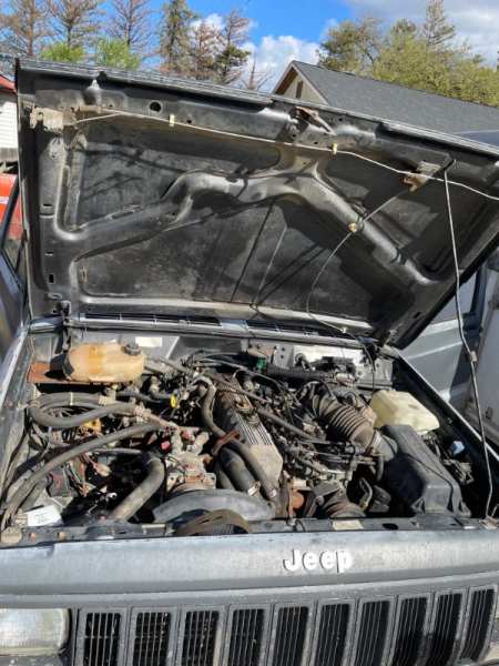

Picked up a crazy low mile 4.0 and started tearing down for building a stroker 4.5 for it. I built a 4.5 for my other Jeep yj and it party’s pretty good so I changed the recipe up a bit on this one, porting head, bigger valves and bigger cam than before. -

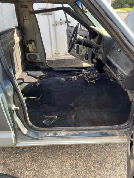

Pretty much a rust free interior and ready for some much needed love, this jeep was a factory bucket seat black interior and all that is moving to another Comanche build I’m saving parts for. That one will be a daily driver with stroker 4.5, ax15 on tons and 40’s, with ac… -

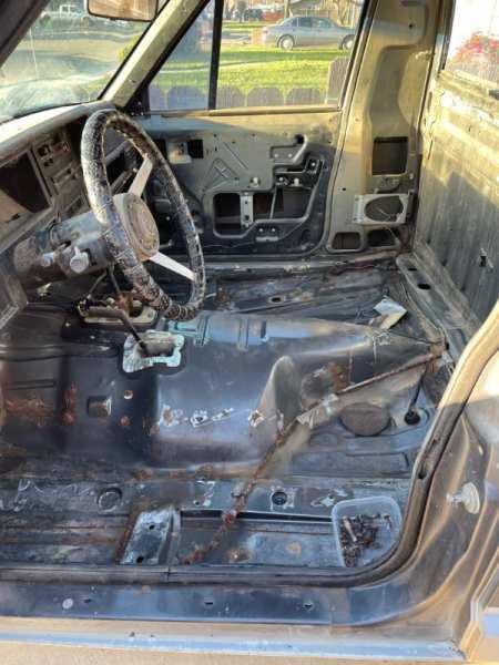

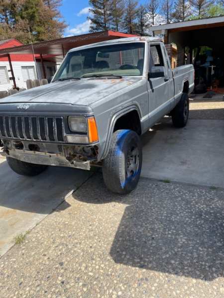

Here is the jeep slightly cleaned up and interior out. At this point I was trying to figure out Dana 44’s or tons. What drivetrain and how I wanted it to look. -

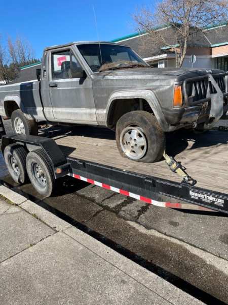

Been building this 88 Comanche for 3 years now and decided to do a build thread on it as I have a ton of pics to go back on. Was hoping to race last koh but life got in the way. Picked this up from the previous owner who rolled it on its side and roof, crushing the roof in the back and blowing the rear window out. I don’t want the purist hating but it was slightly tweaked when I got it… the plan is tons, 35’s, manual transmission, exo/internal cage, Deaver leafs, and a few cool mods 😎
