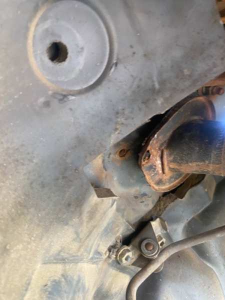

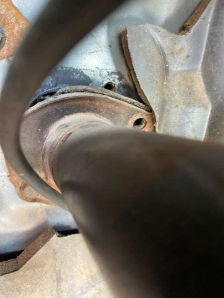

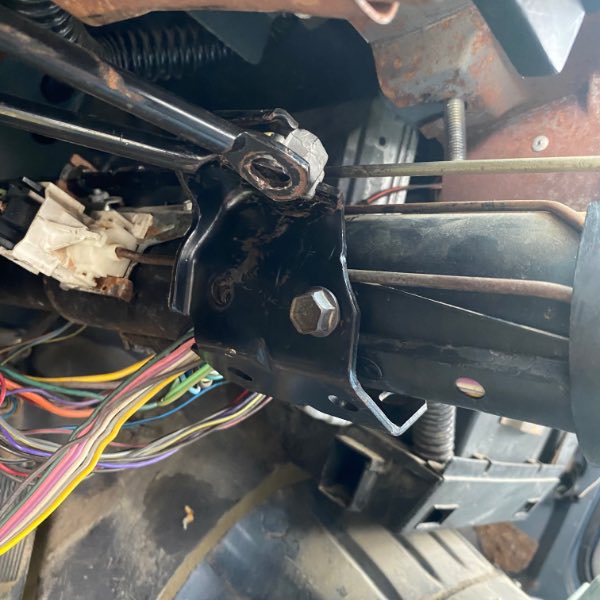

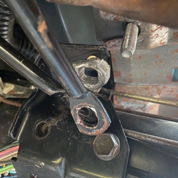

Yeah it’s fully attached to the studs in the dash however not seated in the steering shaft in the picture. Here are some better pictures of the flange which I’m now realizing is way worse than I originally thought. No clear damage around the firewall or anything like that. I really appreciate the offer unfortunately it’s a stick lol I'm gonna keep trying to bend it straighter, hopefully that gets me somewhere eventually lol -

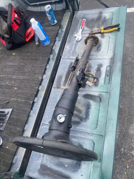

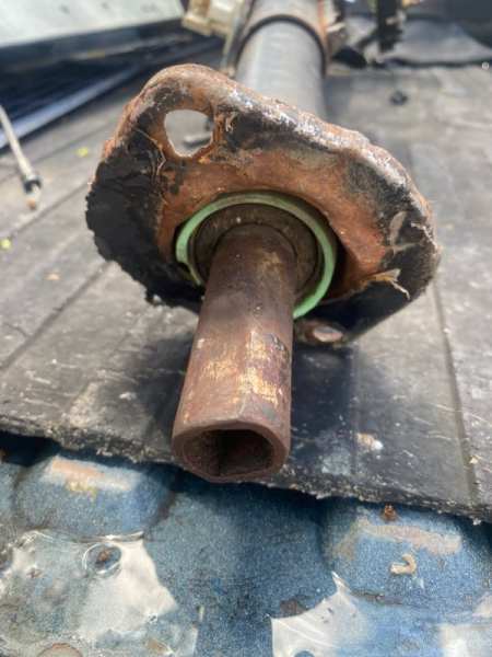

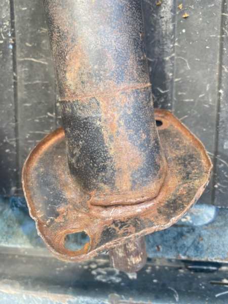

Update: got the column completely out and straightened up the flange as best I could After test fitting the column and attaching it to the dash correctly, the flange is now almost an inch from the firewall. Beginning to think something is wildly wrong here the flange almost looks smashed into the column or something, you can kinda tell in the last pic -

I have the flange fully unbolted and I still can’t seem to get enough length to get it to line up. Is there anyway to get some extra length out of the steering shaft if I unbolt it in the engine bay? -

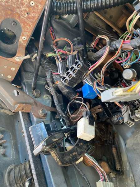

Just realized the one bolt is missing. Anyone have specs on that? Can you elaborate a little more in what you mean? Here are some random pictures if any of these show something I’m missing Side note is everyone’s under dash awaiting this much of a mess -

When replacing my ignition switch earlier in the year I found that the bracket that attaches the column to the dash was only held in with one of the nuts. On top of that none of the bolts that attach the bracket to the column in were there. I have the bolts now but I cannot for the life of me get them to line up properly. Column seems to be almost an inch too far forward. Has anybody else found a solution for this? Found a couple posts that sounded similar in a few different forums but no definitive answers. Thanks!
