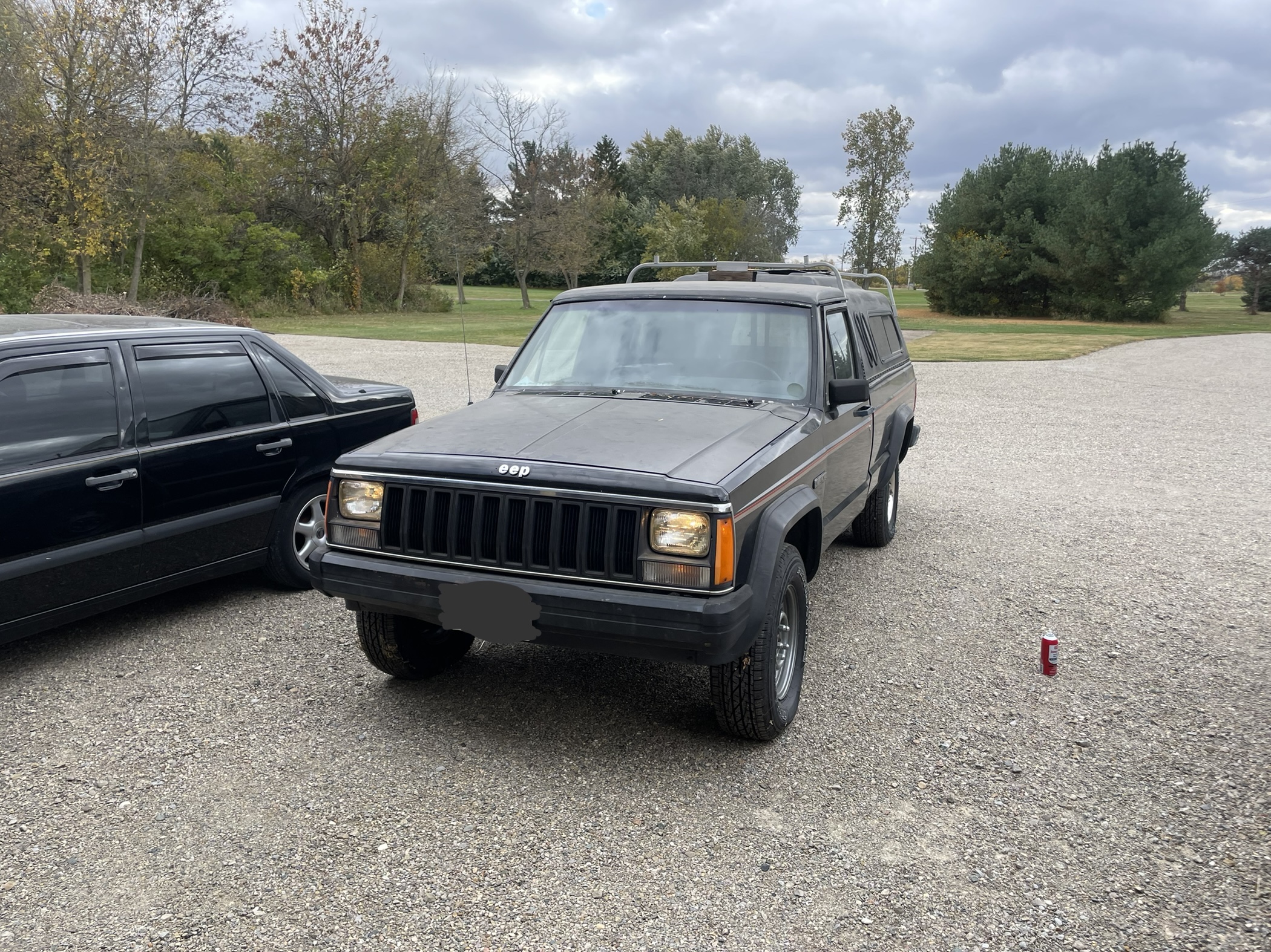

  2. No test drive yet, but for the first time in a few weeks she finally idled long enough to get up to temp! Test drive coming soon
