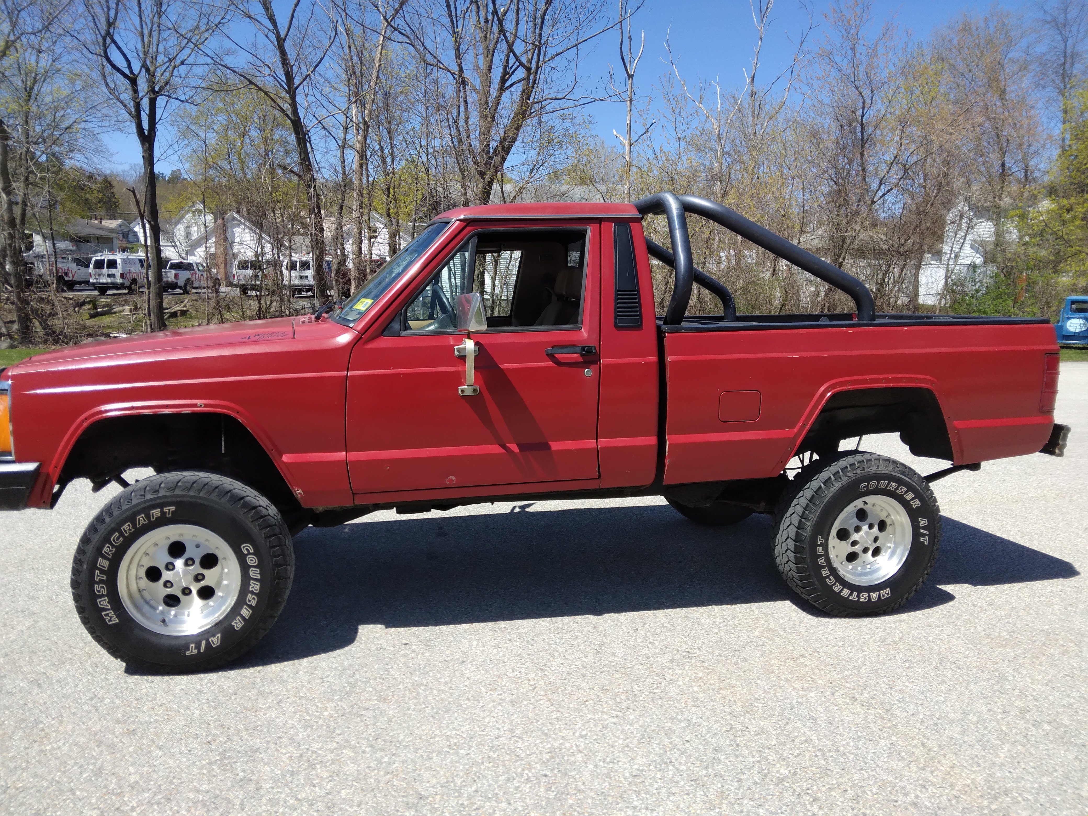

Curious to see what model mj i have, i want to put original graphics on it, but need to make sure I'm looking at the right ones for my mj. The interior has been swapped out for bucket seats, so original options have been changed
Just bought a 87 Jeep comanche, it has the 4.0, 4x4. when i drove it home i noticed that the speedometer didnt work, but the gas gauge did, and the stereo did not. I also noticed that the front blinker works, but not the rear blinker, or brake lights(rear lights work though) after parking overnight i got in the next day to realize that the front blinkers were now not working. replaced the flasher relay, and a fuze to stereo. got blinkers and stereo working, but gas gauge stopped working. Today i went to go out, and noticed that the gas gauge is working, but now the stereo is not. going to replace brake light bulbs today to see if thats the issue with the brake lights, my question, does this sound like a bad ground? is there a good place to start looking around?
