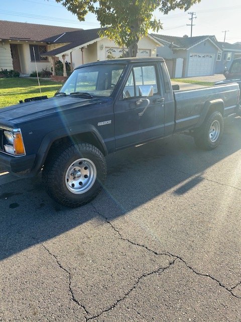

  8. I picked up some indoor/outdoor carpet and installed over the foam. I also found some thin plywood underlayment for the bed sides and front. I used spray adhesive on both the foam and plywood. I first used velcro to hold the carpet panels to the sides but ended up using a couple self tapping screws. Since I'm going into the plastic bedliner beneath, more holes didn't bother me. Last was a Bedrug universal truck mat. I've used the Bedrug on previous trucks and liked it alot. The cut-to-size mat went in very easily and attached with plastic "Christmas tree" fasteners to the bedliner ribs below. I also ran a power port to the back. it has an on/off switch with two usb and one cigarette lighter size port as well as a voltmeter. I ran straight to the battery with a fuse.
  9. Next I started in on the Shell and bed. I grabbed some 1" foam insulation and gorilla glue and went to work. I used a bit of expanding foam in the corners and bigger gaps
  10. Build Update: Someone prior to me installed the incorrect fuel sending unit. I ended up having to drop the tank but it wasn't that big of a deal to drop, install the new unit and reinstall the tank.

  15. That's it so far. Next is to get the bed set up for camping while still allowing for cargo. I'm considering a few different configurations for the back, will keep you updated as I decide. I'm also getting the drive shaft u-joints replaced and have adjustable rear shacked on order from Core 4x4. The rear of the truck sits down slightly so the shackles will take care of that. Overall, I'm pretty happy with how the build is going. Knowing exactly what I wanted to use the rig for makes it alot easier to build it right the first time.
