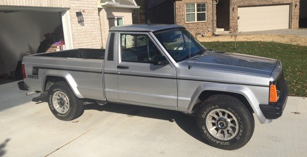

  8. I have an 88 Comanche 4.0 Litre and I'm having multiple turn signal issues. With the headlights on the only signal that works properly is the Right Rear. With the headlights off both rear signals work properly, but the front signals do not. Headlights off results in either both front signals blinking or neither front signal blinking. I attached a table that provides the various scenarios. I don't know if I should start by replacing the turn signal arm on the steering column, or replace the bulb sockets and/or wiring first. Suggestions for how to approach this would be greatly appreciated.
