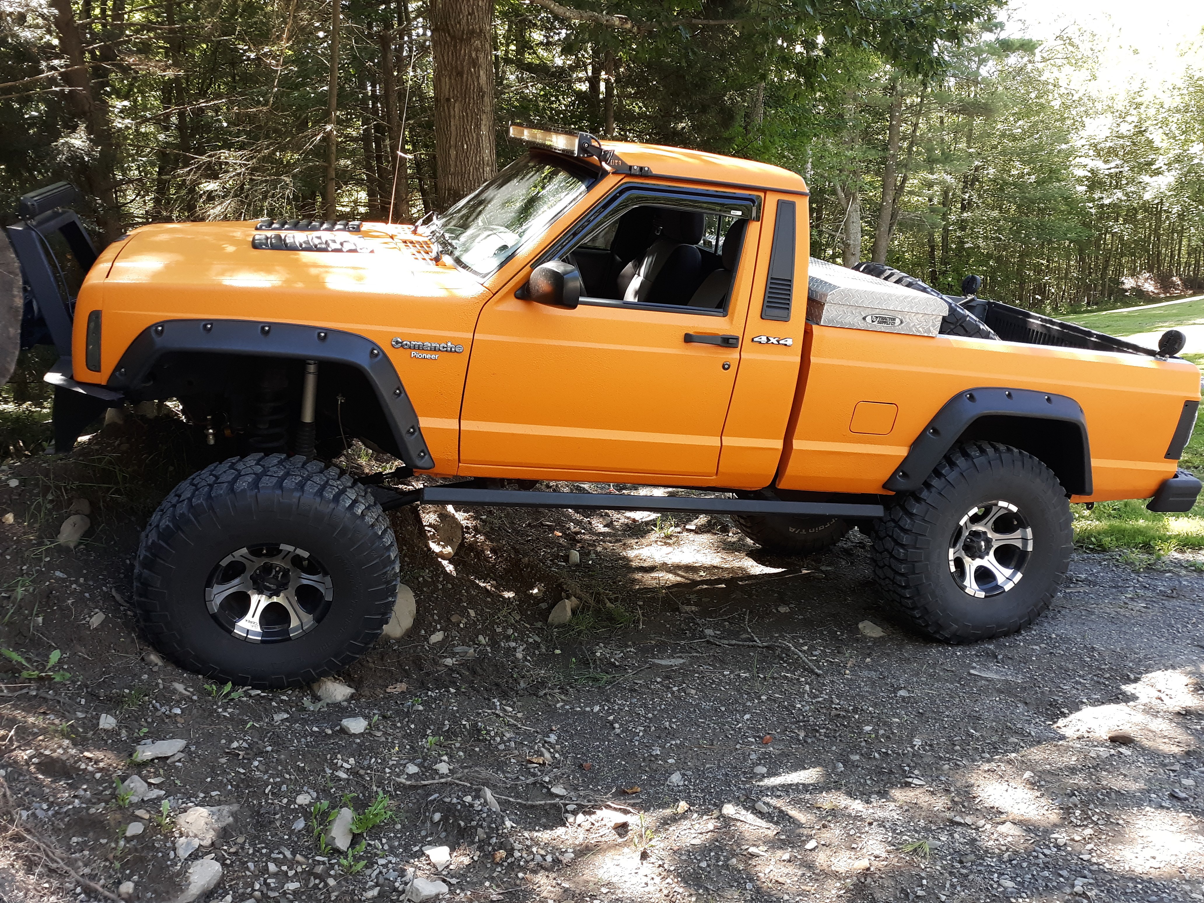

  10. Last summer i came across why the engine had a knock. Originally just replacing a rear main and oil pan gaskets when i find.... All bearings were trashed, had oil pressure issues when hot but otherwise ran fine and at redline! And all this metal was in the screen and bottom of pan, no idea to this day how a piece of a ringland could end up in pan with no holes in pistons, guessing this had a prior cob job. And a cracked oil pump.... So it was time to build that spare motor i had hiding away.... Out with the old.. In with the new, and of course all new gasket, Valve stem seals, timing set, harmonic balancer, oil pan, 12 port injectors, dynomax headers, 62mm throttlebody, new paint, and ofcourse hemi orange for the valve cover. Alot of work but well worth it runs smooth as silk, and no more oil spots.
  11. But wait theres more.... Made some rock sliders They are made from 2x4 .25wall tubing, and are removable with two bolts, they slide into 2" recievers welded to frame.
  12. Winter can be long in upstate ny, and this MJ doesnt see winter roads soooo the backyard woods it is... Next I added a winch and some napier hood vents! Winch is a 10k smittybilt x20 with wireless remote and sythetic line.
  13. The first run after paint!
  14. Now for final assembly after paint, and to add some flare! I used napiers flares, after seeing bushwackers fade, i decided to try napiers after reading rave reviews. Happy to say that after 3 years they look great still. These pictures are from July of 2016, some of the bolt on used at this point on the body include, Napiers flares Farmer johnson offroad light mounts Amazon special led light bars 50" top, 21" front and pods on rear. Rustys rear light buckets Bumpers were homemade and fully winch capable...in the future.
