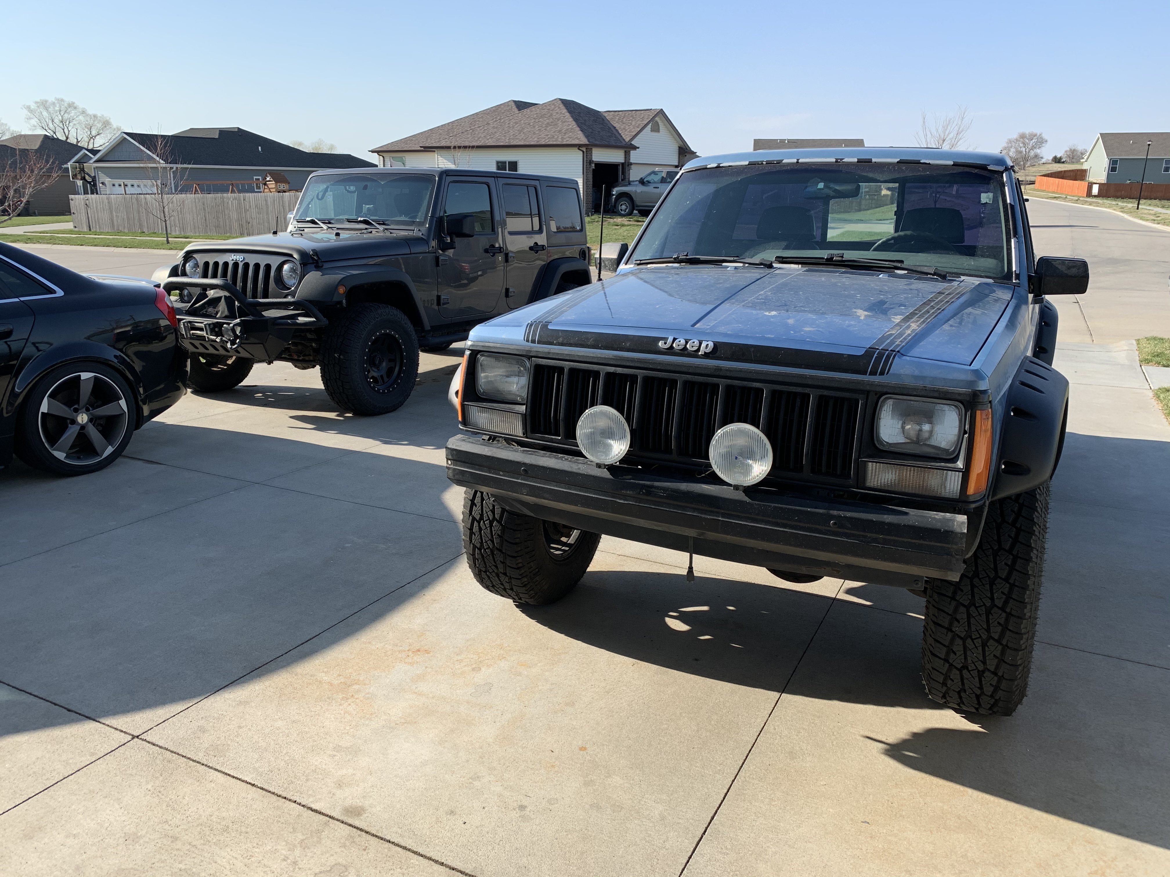

  13. Put my spacers back on. Just need an alignment, appointment is Tuesday. Before vs after for the pics
