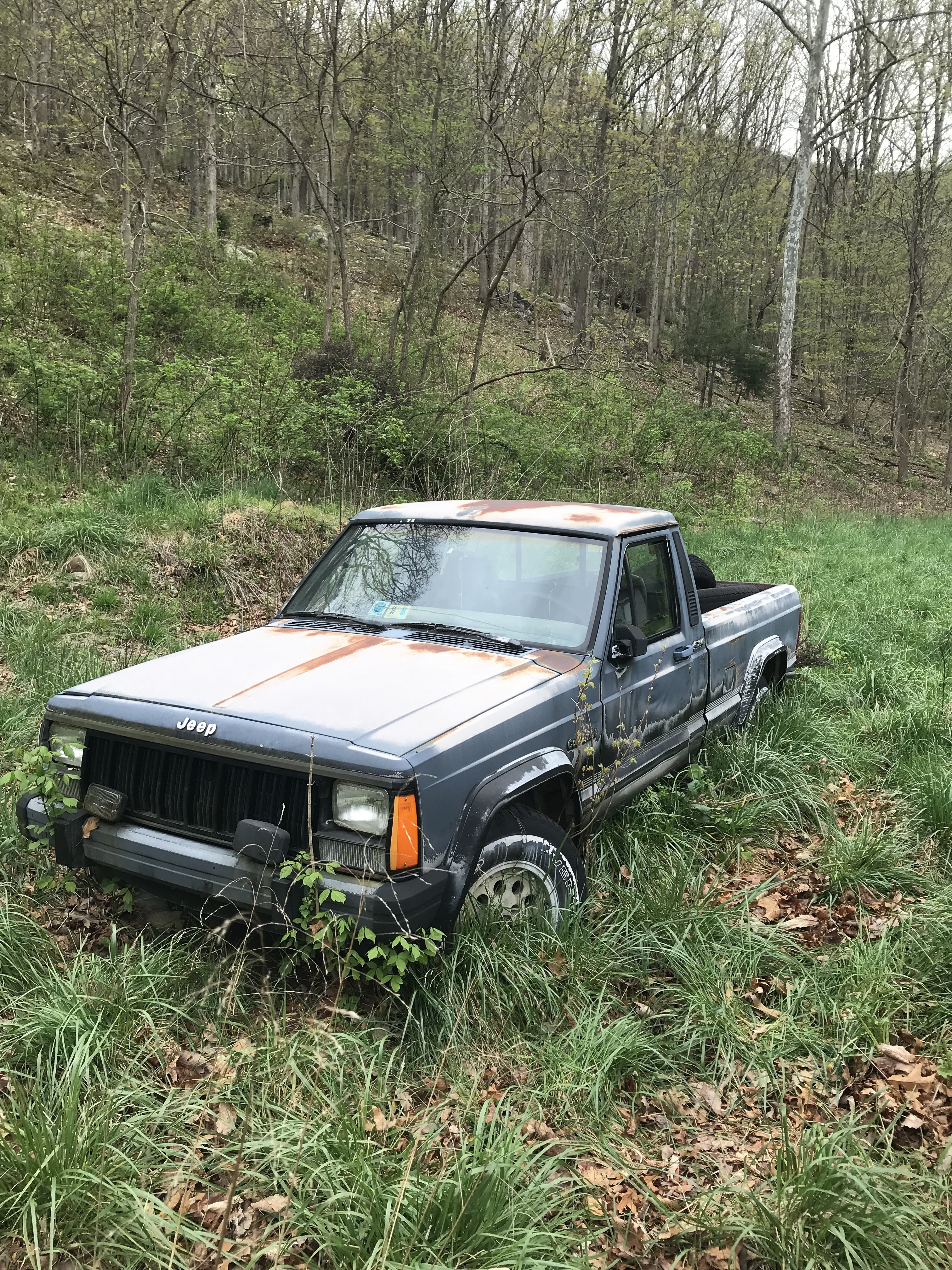

  20. It required a sledge Hammer to get the wheels off. They were basically welded on by rust... Also found a cool Mopar Accessories pamphlet in the cab.
  21. Haha, yeah this is fresh out of the barn.
