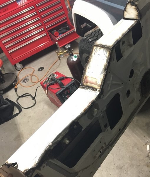

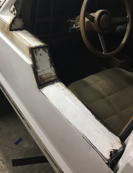

  8. Yea I’m going to cut the bottom section off the door side hinge for both my half doors and full doors and replace weak factory pin with some 1/4” round bar. That way I can swap them on and off quickly. I’ll install a plug on the truck side of the speaker wires so I don’t have to deal with the speakers every time I swap doors. Today day I welded up the angled sections. I also went and picked up some new door panels to modify to fit my half doors. I ran out of time(don’t like being loud for my neighbors sake) to grind the welds smooth so I started modifying the panels. I think they’ll look pretty good when I get everything buttoned up. I figured out that XJ rear door handles have the same bolt spacing as the front ones. The angle I cut the doors at just barely cut the top connection in half. I could make the fronts work, but honestly I like the way the rear XJ handles look.
  9. Well I started at ground zero for the electrical system. I took off the battery cables and cleaned the terminals and posts. I seriously cannot believe it, but it fired right up after that. My flabber was thoroughly gasted. I also got my passenger door cut up. Today I'm going to the junk yard to find some new door panels. I want to make my half doors look as factory as possible.
