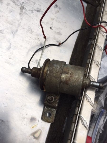

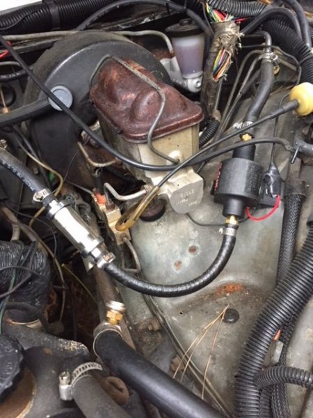

  19. I had wondered about the electric pump but the other “similar trucks I had run in the past had the inline electric pumps. I’m no in depth mechanic but just wanting to get it running so I can do mybthink with it, the body. This was a truck my dad had wanted and we bought it right before he passed. If I can get it shaped up like I want my plan is to have the motor swapped. Hopefully with the cheapest and easiest swap. I’m attaching pictures of the pump that was there when we bought it and the last one I swapped out. Just wondering for my purpose should I continue on getting this electric system going or to replace the mechanical. Which until now I haven’t even looked for but guessing it is located somewhere on the drivers side of the block seeing that’s where the lines from the tank come from. Also I am in the process of pulling the bed. Wanting to pull tank and clean out and check all lines back there. Thanks for all the help. Like I said just a guy with a few tools and a little knowledge. But most of my tools are for collision repair.
  20. Have gotten really confused after search the links. I have an 86 mj with the 2.8 and the fuel pump is electric not mechanical and mounted on the inner fender not in the tank. I have replaced it with two different pumps from the local parts store and can’t get any flow also making the worst sound ever. Ticking. Lightly put. Where do I go from here????
