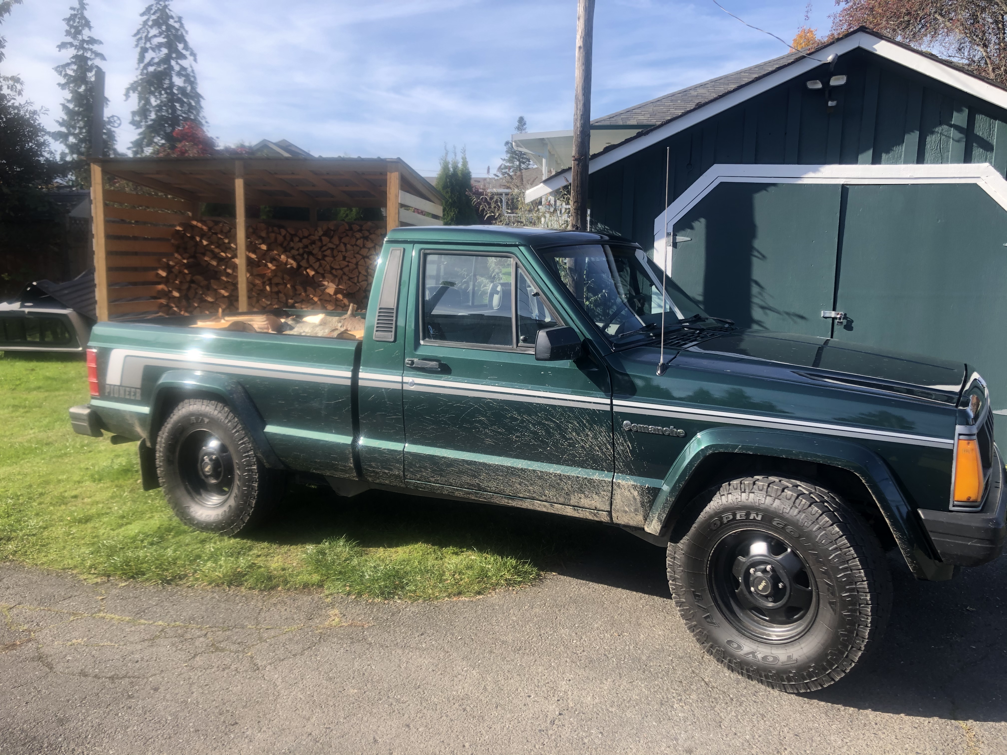

  1. It’s a 1990, but I re-sprayed it PG8 which is a dark forest green metallic paint. Really brightens up in the sun!
  2. Yeah it’s a SWB, I’m located in Canada BC so hopfully somebody close-ish can help me out lol
