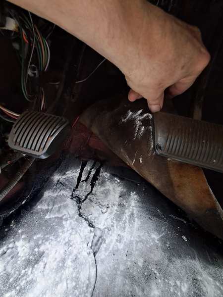

The baby powder trick worked great!!! Now I need to pinpoint the leaks for repair.
Driver side had one up under the foam pad behind the pedals. It's likely coming from the firewall, correct?

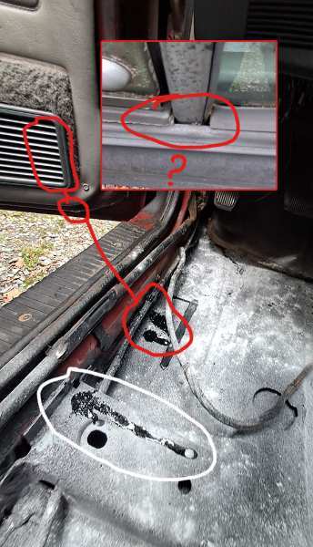

Also, Driver side had water on the door speaker grill as well as the floor. There is a small gap between the vent and main windows. Maybe leak is there?
Last leak on driver side I think is coming in from the top of the door frame.  don't know if the seal is bad or the door frame is bent or both. Water will come in through there if run through a car wash.

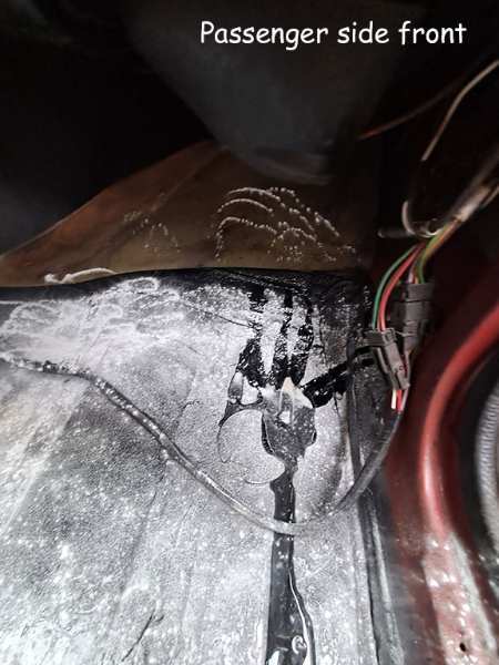

The passenger side leak is also firewall, I think. Before the rain came through, I took off the antenna and coated the plastic parts with flex seal. Thinking that and potential leaks from there would be solved.

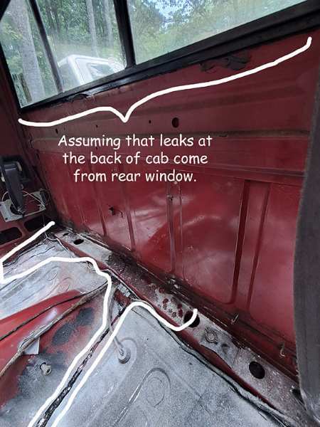

Then there is the back window. Are the seals around the window the only areas water will leak? Is that repaired only with a new gasket?
