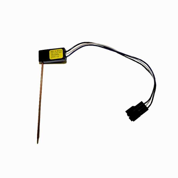

aris_garage_builds Posted 21 hours ago Share Posted 21 hours ago I'm currently refurbishing a 4.0 HO HVAC Box to swap into my MJ. Mine did not come with factory AC, so I'm planning on adding it while I already have the dash pulled apart for my 4.0 swap. Although I ran into a bit of a speed bump - while disassembling the HVAC box I broke the thermostat / probe that connected the the AC evaporator core. I'll include a picture below of the part. I've done some researching and it appears this part is no longer made / quite hard to find. Is there a good option for replacing it? If not is there a way to bypass it? Or possibly a way of upgrading to the 97+ AC core that doesn't have the probe? I'm using a 95 / HO wiring harness for the engine swap so would love to avoid OBDII parts if possible. Appreciate any advice, thanks! Link to comment Share on other sites More sharing options...
AZJeff Posted 13 hours ago Share Posted 13 hours ago Are you trying to use the evaporator from a 97+ XJ in your MJ? If so, doesn’t that require the use of the corresponding heater box? Link to comment Share on other sites More sharing options...
