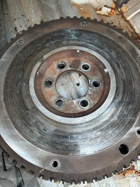

Update time, I consulted a few of the mechanics I work with and they reckoned that my flywheel is fine, just clean it up and stick it back in, so I did just that a few weeks back. Fitted my new transmission and then realised that while I'd ordered an XJ clutch hydraulic assembly, the store I’d ordered from actually sent me one for a Wrangler, and it turns out their stock is mislabeled and they don't actually have the correct one, so I had to return that and order one from somewhere else. Fortunately the replacement was correct and was a pre-filled and pre-bled type, so I installed it this past weekend. I think the clutch pedal assembly on the 1995 XJ must be slightly different to the 1990 model, because I had to drill out the eye on the end of the rod for the master cylinder a bit, and it sits at a slightly funny angle, but it does seem to be working, I just need to modify the plastic eye a little bit more so I can actually install the split pin. I decided to try to take the Jeep for a short drive down the road to test the new clutch and transmission, and it went a bit poorly to say the least. It's sat for a few weeks without starting, and the battery is of questionable quality, age, and health, so I didn't think much of it when it needed jumpstarting, but I got it going and set off. IMG_3153.MOV I stalled it, no big deal. but then it wouldn't start even with a jump pack on it, and it's blocking the road. Uh oh. After a bit of a panic we eventually used my Jimny and a spare tire to shove the Comanche off the road, where i was able to jumpstart it with the Jimny and get it back onto my driveway. While it was marooned in the middle of the street, I realised both battery terminals were loose, and when I tried to tighten up the negative terminal, the bolt just ripped right out of it. And then, after parking it back on my driveway and digging into it a little, I discovered that the positive cable was just twisted together where a new end had been joined to the original cables. And the end of the positive cable connecting to the starter was pretty badly melted. So, it's no wonder it didn't want to start. Thanks, previous owner. Fortunately, I have a pile of spare battery cable and some terminals in my toolbox at work, so I made up a new set. They're slightly too long, so I might have to shorten them a bit, but they were free and the Jeep seems to like them. Next step I think is the tires and a radiator. I have a set of tires for it so hopefully on Friday I'll be taking the wheels off and getting them changed and balanced at work. As for the radiator, I don't know whether to look for a capless radiator like the one I have already, or upgrade to one with a cap. I don't know if it's just a straight swap or if you need to alter other parts of the cooling system, too. Research is required. -

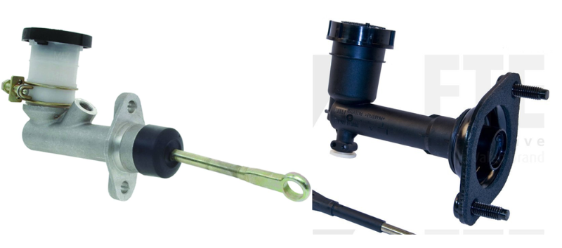

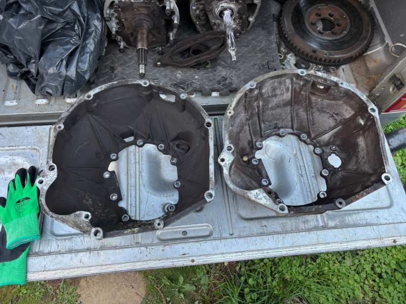

Bumping this one to save making a new thread, My replacement AX15 from a '99 XJ turned up this week, so I've pulled my transmission. Apparently what I’d read about the 4.0 and 2.5 bellhousings being different is wrong, because the bellhousing that came with my transmission looks like it'll bolt straight up to the 4.0. I'd like to use it and switch to the external slave cylinder. The master is a bit suspect and the hose is worn out so I'd like to replace the whole clutch hydraulic system with a newer setup. Do i need to keep my original style master cylinder, or will the newer, plastic one fit the same holes? I can't find any measurements to compare them but the pictures make them look pretty different.

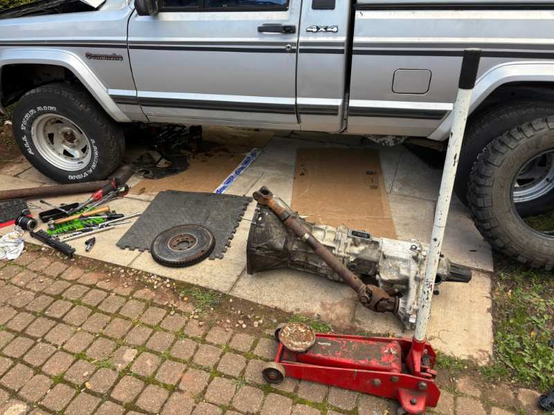

Finally a bunch of parts and the replacement transmission turned up this week, so today my brother and I ripped the old transmission out. It wasn't too bad a job, but I made several discoveries along the way. Firstly that the transmission jack I have sucks. Second, I'm not really sure if the transmission was even the problem. I set the new one (from a 1997ish 2.5TD XJ) and the old one side by side, and they both feel about the same going through the gears, and none of the gears feel loose like the shifter is about to slip out of them. I don't know accurate of a test that is, but it was interesting. I already know the clutch wasn't bled properly so I'm starting to wonder if that was the problem. The clutch, pressure plate, and the internal slave are nice and shiny and new, but the flywheel looks pretty hammered. I don't know if these can be resurfaced, but the last time I took a flywheel to my local transmission shop they said they don't resurface them any more. I might ask around and see if anywhere will, but replacing it isn't expensive, so I’ll probably just do that. I'd read up on it while shopping for a gearbox, and it seemed like the 2.5TD and 4.0 bellhousings were not the same, so I thought I wouldn't be able to use the bellhousing from this transmission. Now i have them both side by side, they sure look the same to me. I'm going to try bolting the newer one up tomorrow, and if it fits I'll order an external slave cylinder and a new throwout bearing for it. Also going to order a new master cylinder, as despite my best efforts to plug the disconnected clutch line, it's still leaked all its fluid out and if it's anything like a brake master, it'll probably need to be removed and bled. So I may as well just fit a new one while I'm at it. The other thing I've learned while crawling around under the Comanche is that it needs a rear main seal. I thought you'd need to pull the transmission to do that like on some other engines, but it sounds like on the 4.0 it's actually really hard to do without the transmission holding the engine up, so that job can probably wait until I can get it over a pit at work. -

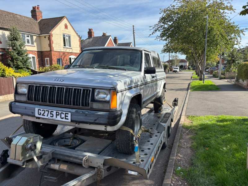

I picked up this 1990 Comanche Pioneer a few weeks ago. it's a 4x4, 4.0, 5 speed manual shortbed model that's apparently been sitting for 20 years. The guy I bought it off replaced the whole fuel system from tank to injectors, replaced the clutch and got it running before giving up, so now it's my problem. I didn't need a third project car, but here we go. It's pretty clean for a 36 year old car, very straight and minimal rust. It has one small hole in the floor and a couple of pinholes in the roof, but those can be fixed pretty easily, then the whole thing is rust-free. I plan to paint or undercoat it before too long to protect it, but for now I'm just focusing on getting it back on the road and able to pass inspection. The biggest issue is the transmission needs replacing, and the clutch needs bleeding properly. 1st gear is essentially unusable, and it grinds going into the others. Rebuilding it would be nice, but even if I do it myself it'd be very expensive. I have a line on a replacement, but I’m just waiting to hear back about it. Besides that, the only other problems are mostly just age related. The engine obviously needs servicing and going through to make sure it's running right, but it does run, so it's a pretty low priority at the moment. It needs every suspension bushing replacing, new shocks, new U-joints, new oil in the diffs and transfer case etc. I plan to maybe rebuild the axles at some point down the line. Eventually, the goal is to clean it up a bit and make this thing a daily driver. I'm not going for a full restoration or upgrade, just trying to bring it back from the dead. Here it is stinking up the driveway with my current daily/1st project car, my '90 S10 Blazer.
