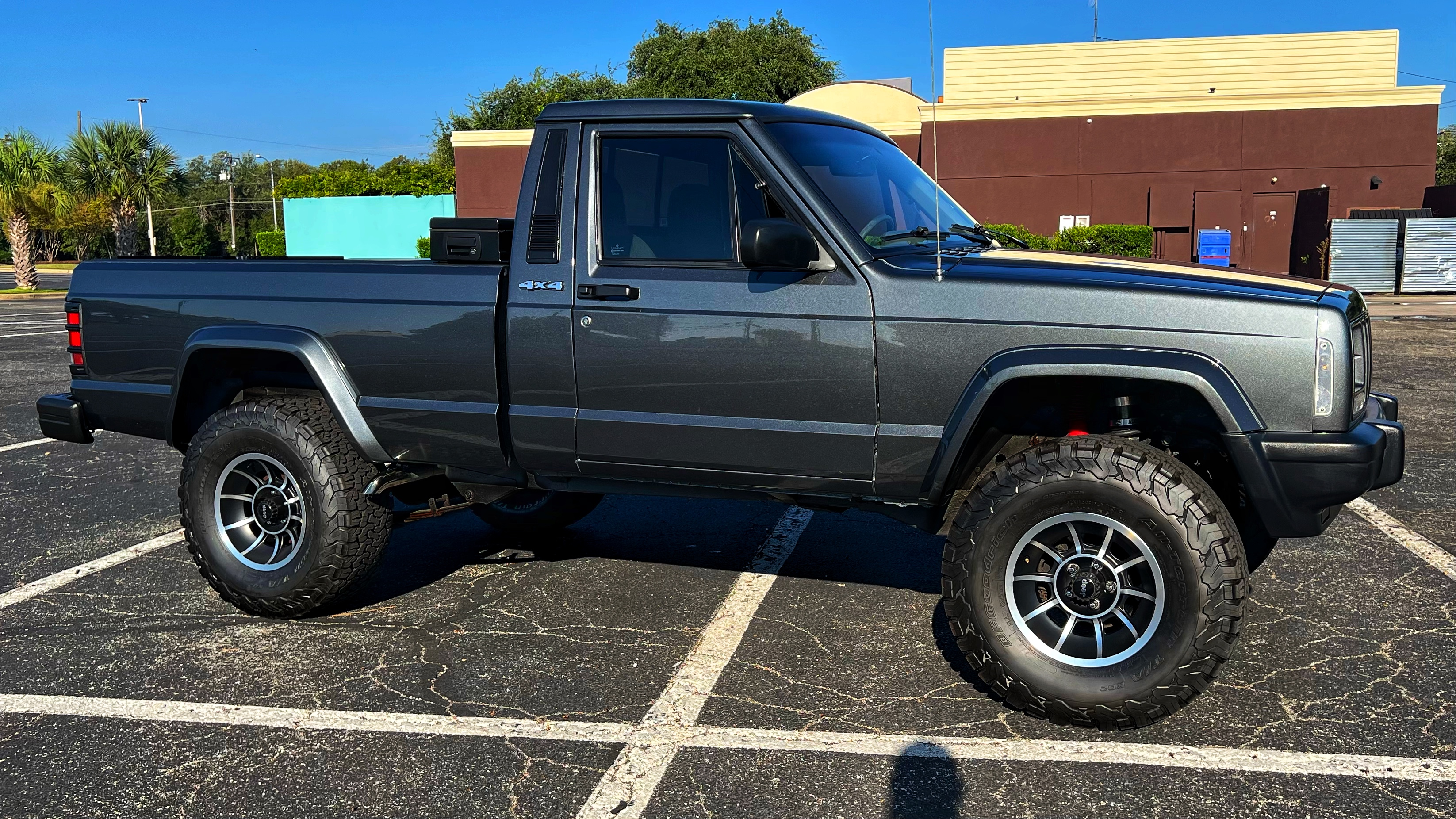

Comanche Pioneer's Achievements

  2. Hey all! A few pics of my truck and parts haul for attention. I recently completed both a closed-to-open cooling system conversion and a fairly comprehensive HVAC renovation on my ‘89 Comanche. Good news first: the A/C system held vacuum for over 2 hours before charging, and the air is now blowing ice cold. So mechanically and thermally, everything appears solid. That said, I’m having airflow issues at the vents: The system only gives real airflow on BI/LEV, and even then, the floor vents dominate. On MAX or Normal, airflow at the dash vents is extremely weak or nearly nonexistent. When switching modes, I can hear the blend or mode doors moving, and the airflow sound shifts, so I know something is actuating. My understanding is that most mode door actuators are on the left side of the HVAC box, with the recirculation (MAX A/C) door behind the glovebox. Given that I’m getting good cold air and door movement sounds, but almost no output on MAX or NORM, it doesn’t seem like a total vacuum failure. I’m starting to suspect the recirc door is stuck or not opening, which would restrict intake airflow, especially on MAX. The fact that BI/LEV works (albeit floor-heavy) supports that something is partially functioning but not fully moving through the correct routing. Any of you run into similar issues? Does this sound like a stuck recirc door or something else deeper in the blend/mode door system? I really want to eliminate all possibilities available short of removing the dash and completely rebuilding the HVAC box. Thanks in advance for your help!
