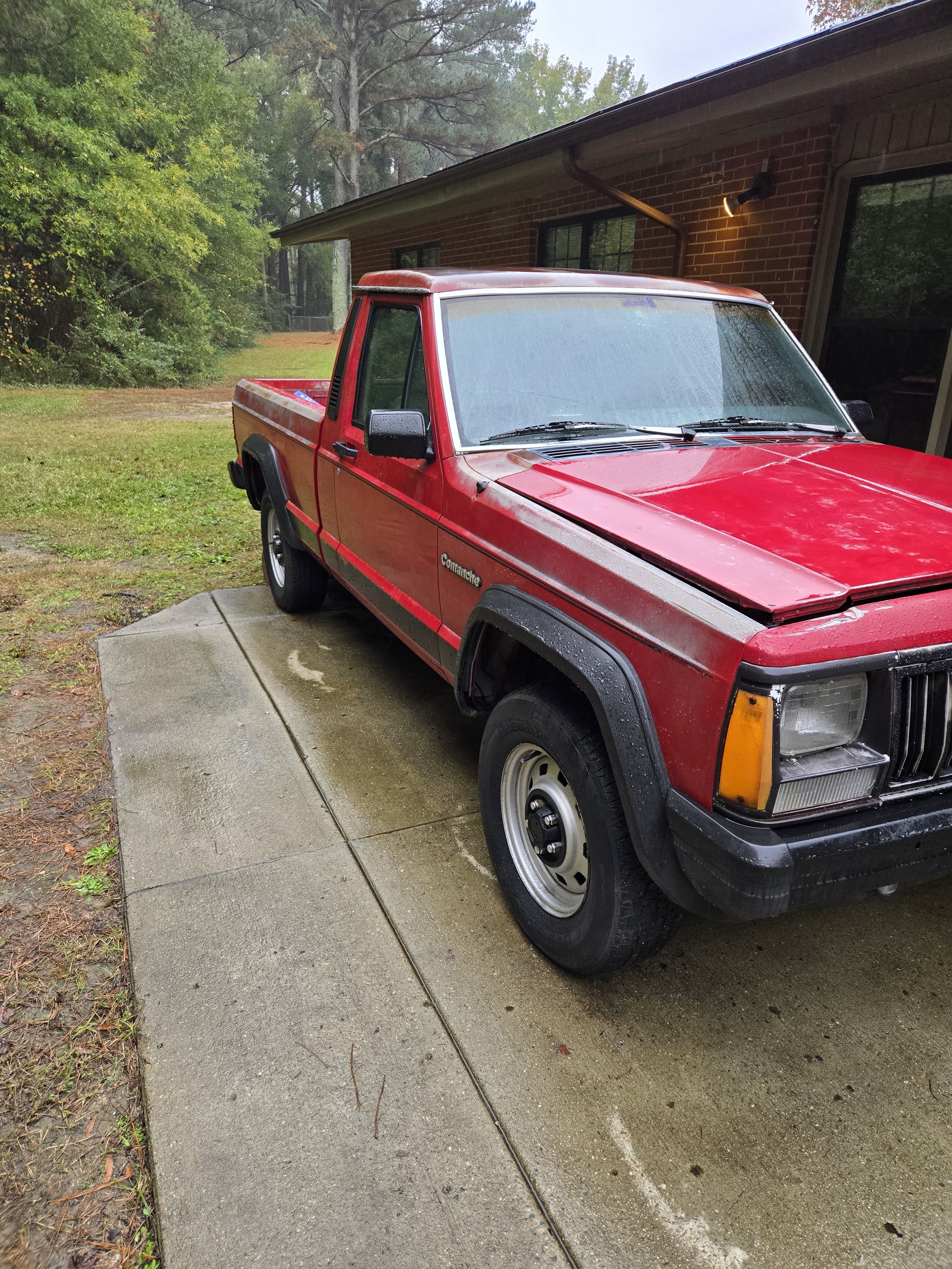

  7. I bought a 1991 Comancher 2WD, 2.5L a couple months ago. When purchased it would start and sometimes kick off. PO said he though it needed a new radiator as it would overheat. Fixed the overheating issue and went about chasing a low oil pressure dummy light. When I took off the rocker cover it was super dirty and full of crud. Cleaned that out and dropped the oil pan to clean up the pan and the oil pickup tube. Since putting everything back together I can't get the jeep to turn over. I have verified pressure in the fuel rail and can hear the pump kick on when I turn the key. I have verified spark. When turning the key the engine will crank but will not turn over. Any advice, ideas, or help would be greatly appreciated.
