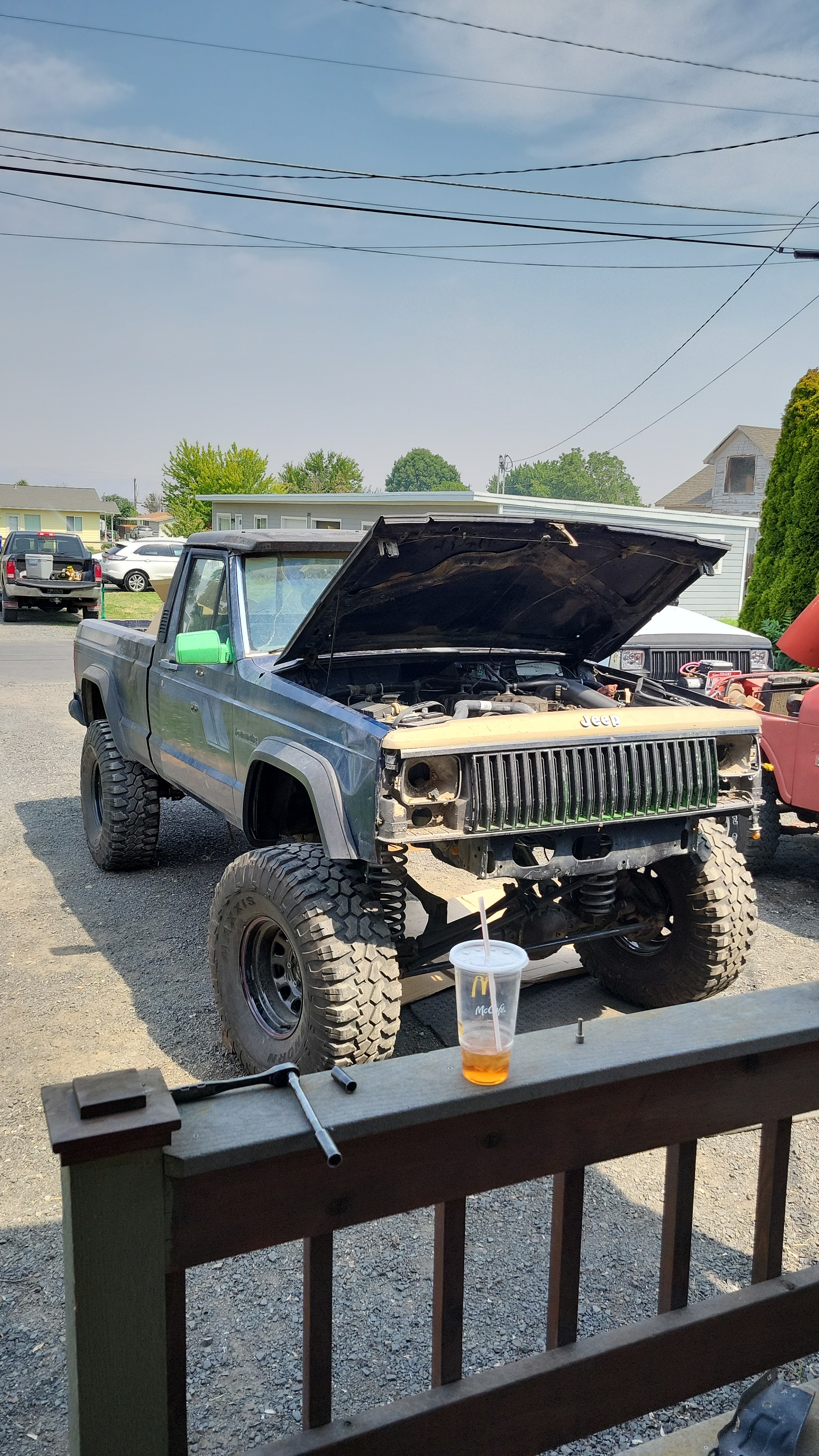

  3. Plastic, both have been replaced previously
  4. Ok, sorry for multiple small posts... figured out passenger turnsignal light socket was faulty, replaced it. Front lights work except turn signals, gonna try relay next cuz flashers work. Took hazards flasher and put into to turn signal flasher and no change. Rear lights will turn off when turn signal is engaged but no flash
  5. I'm am going trough and checking grounds ATM also tried just running a 12v wire to the plug where the front harness connects in the engine bay, i can see the bulb trying to light up but its not bright in anyway shape or form. and i have a 94-01 cherokee repair manual and tahts what I'm going through atm
  6. hi, I'm having the same issues in my 87 MJ. ive swapped over a 91 ho out of a laredo i belive, donor was beat to all hell and had no doors so not 100% sure on trim level. anyway, 91 engine, harness and dash harnes, fires up and runs good. but am having lighting issues. before trying to hook up rear lighting all front lighting worked the way it should other than turn signals. i follow this pin guide and now i have break lights, and tail lights, but now only left running light in the front and only right turn signal in the front. and turn signals won't work with brake lights on(the just stay on and won't flash) i have been working on lights for about a week and at my wits end with this. i don't understand how lights went from working to not and only working in certain modes.
