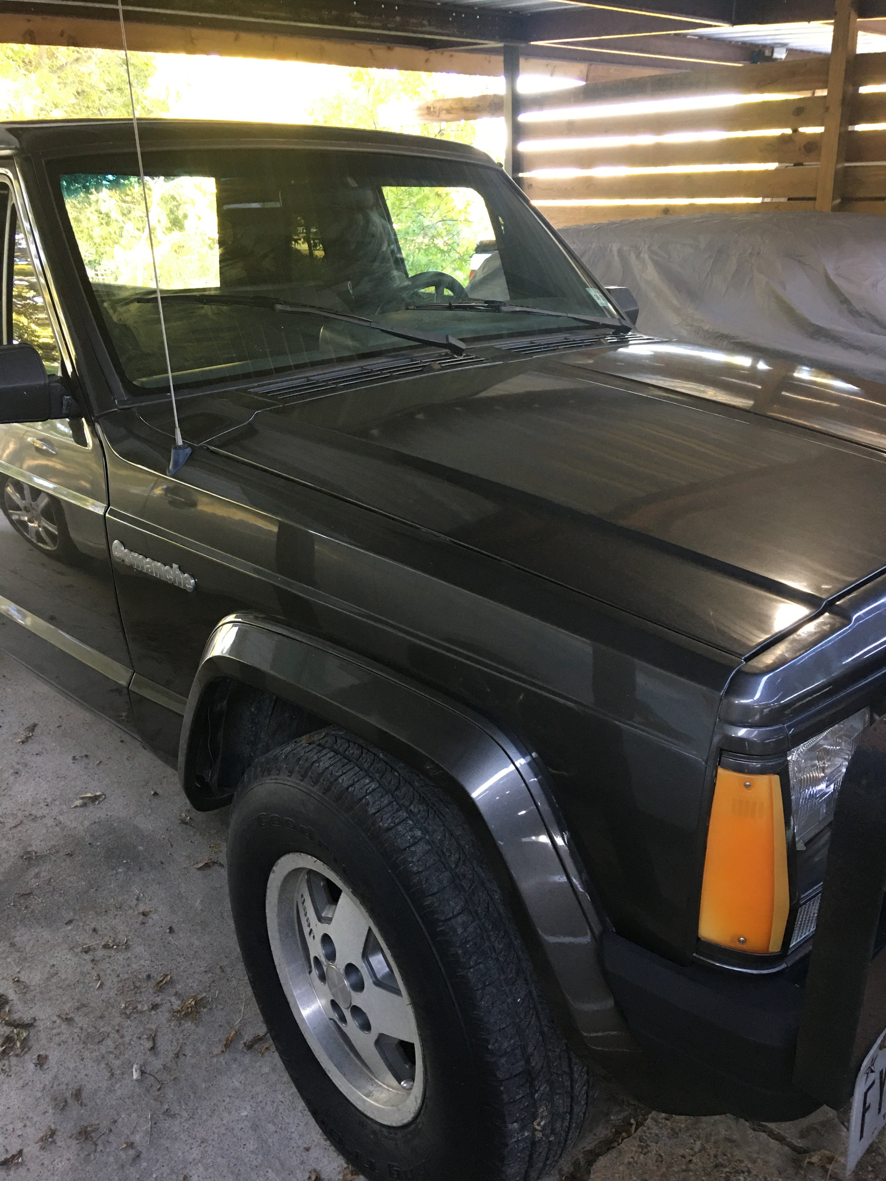

  5. What about sourcing a newer style bracket for idler? I left the one on the ‘96 at the junk yard not quite thinking it all through🤦🏻
