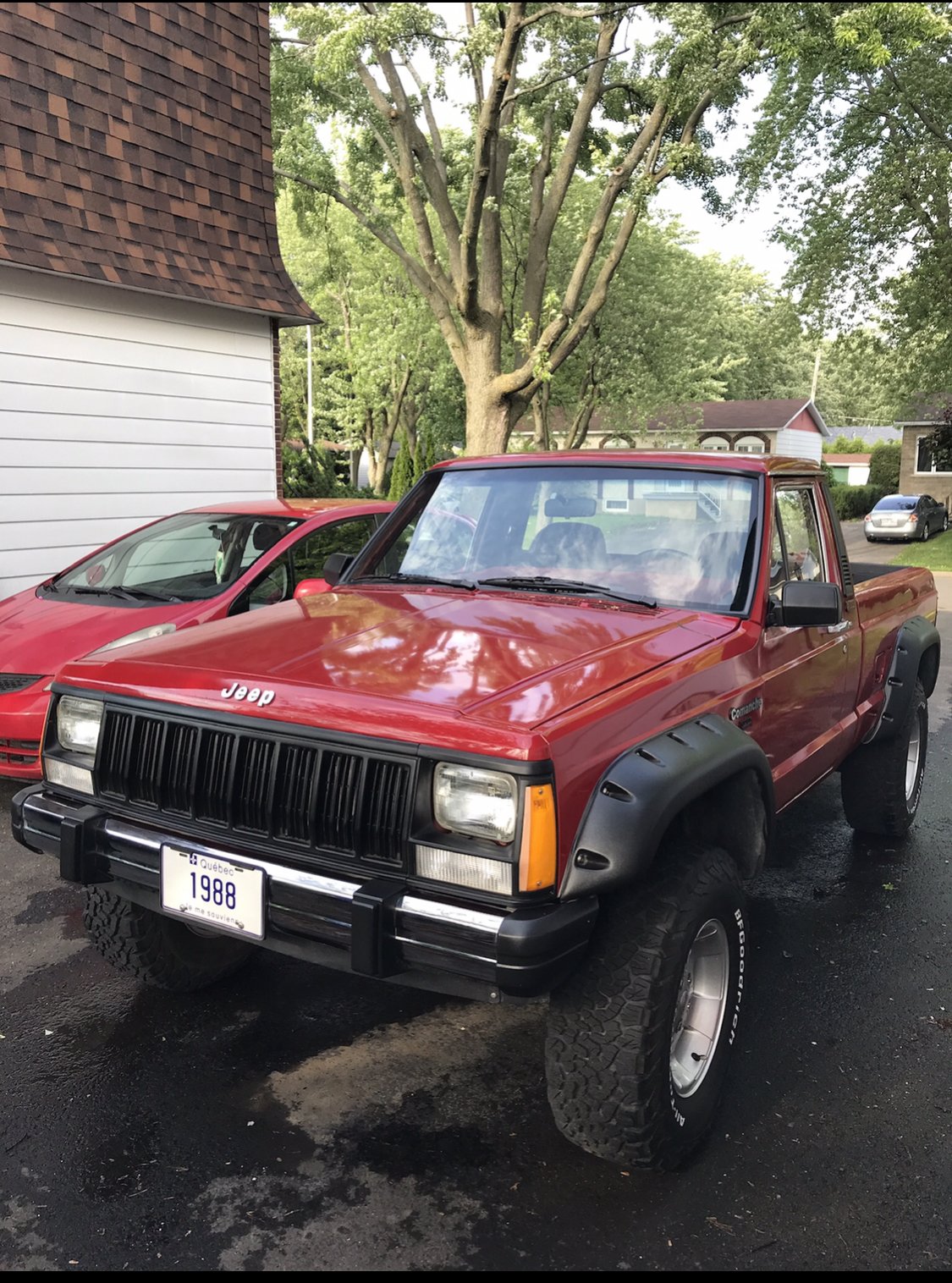

  1. Found the Problem. I had a kill switch installed and cut the battery off. This caused the Microprocessor to Reset. Kept it plugged in and it starts on the first Turn.
  2. The thing is if it’s above zero, it starts on the first try. The ground problem has been upgraded.
  3. 2.5L The engine turns over but takes up to 4 times before ignition. I replaced all the ignition. The Battery is New. In above freezing it starts immediately.
  4. I’m having problems starting my 1988 Jeep Comanche when it’s very cold. I have changed the ignition completely and the Gas Filter. It starts perfectly when it’s in the 40s outside. Any ideas.
