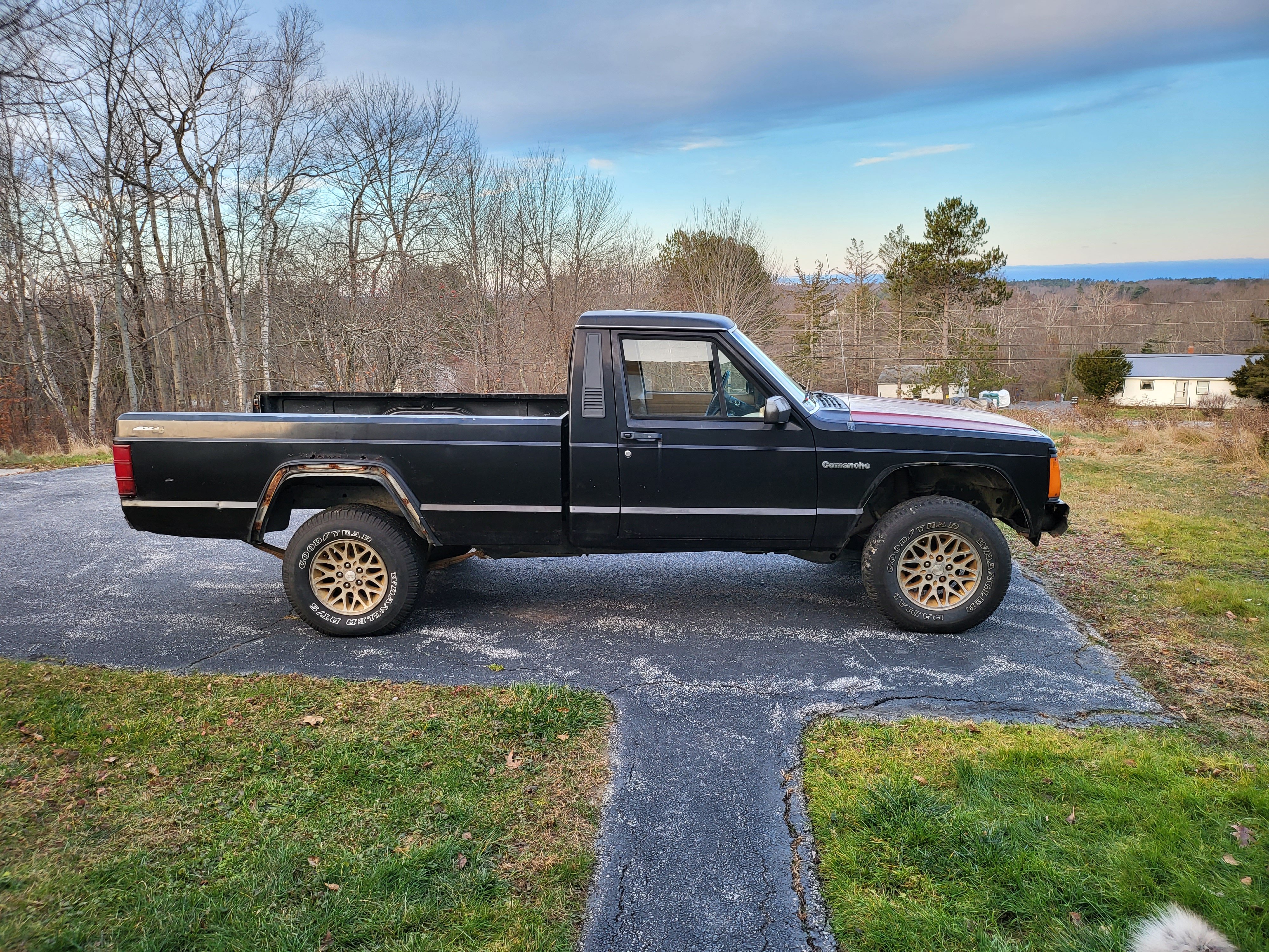

    Year, Make, Model: 1988 Jeep MJ Engine / Trans / Transfercase / Front axle / Rear axle / Wheelbase: Stock 4.0 / Peugot 10/5 (Speculated, but not confirmed. It looks original anyway) / NP231 / Dana 30 / Dana 35 / LWB Build date: See picture: illegible Current Location: Central Maine; just purchased from southern Maine Status: Currently running, but needs body work so it is in the garage until I "finish." Notes: Tan interior. Tan vinyl bench. A previous owner added a flip-up sunroof. Current owner: Das me! Plans: I have a 2000 XJ from which I plan to swap the engine and dash. I am going to install Corbeau Trailcat seats on custom bracketing (the entire floor was removed and I have to piece it back together ). I am considering the front end swap but I'm not sold because I rather like the more square 80s aesthetic than the 97+. I don't really want to do the dash either, but I want airbags since this will be my daily. I'd love to get a 44 for the rear end. I'm adding a touchscreen head unit, backup camera, and keyless pushbutton start because why the hell not. Need to pull the bed and POR15 the rear frame. Will undercoat the bottom of the bed and the interior of the bed. I'm also going to try to build my own tailgate just for the fun of it. Finally it is getting painted Jeep's Sarge Green since the current paint is unsalvageable. I am also open to any suggestions!
