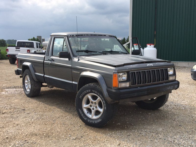

  7. Hey! I’ve usually been a social media guy, but as I’ve shifted away I’ve found this site most helpful so far. So I thought I start off by saying Hi and asking for some help. I just bought a 1989 Pioneer from a guy flipping it and didn’t know it’s history. I’ve figured out a few but unsure about others. So it’s SWB 4x4. It’s had the rear axle swapped for a 2006 KJ looks to be well done. Front driveshaft is missing but picked up a used one. Transmission appears to be a AX15 but lacks that middle plate that’s on most of them. It has 242 transfer case. 4L was replaced with one with 70km a few years ago (thanks to note in owners manual) but motor appears to be HO judging by valve cover. Several sensors in exhaust have no wires coming from them and some do. It came with the shifter boot off and when I put it on it started popping out of 4th. Noticed the console was also notched a smidge and the shifter is not MJ as it’s really tall. There’s also what sounded like a really loud exhaust leak but went over whole exhaust and header looks new and exhaust has no holes. Noise is only when accelerating, while constant speed or decel noise is gone. Seems rather low on power as well. I just ordered a xj shifter SS from reading posts on here seems like might be the issue. But don’t see why someone would cut the console and not just get right shifter as you can’t drive with boot on anyone. Looking to get 4x4 working, fix noise and figure out exactly all they’ve done. So any input on what transmission I have? If rear end would be limited slip or should I put a Dana back in? Looking to definitely get the shifter boot to function and fix the notch in the console. Thanks for any and all help.
