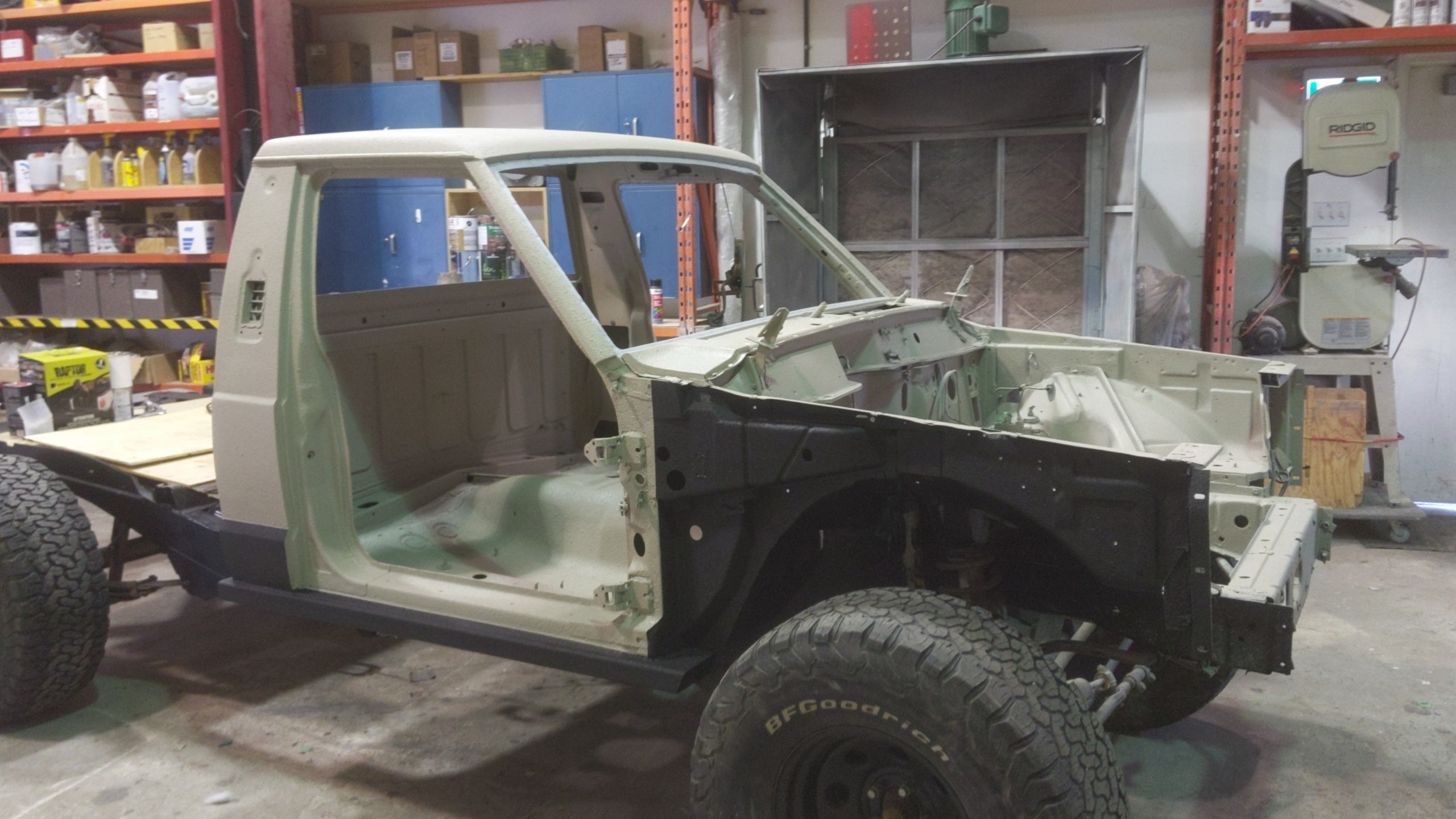

  4. Yeah I got it all figured out I just grabbed the plug for the NSS and looped it then I had one plug that was wrong so I moved that and it got power to the solenoid. Fixed most of my electrical problems now, only thing left is the dash lights won't come on.
