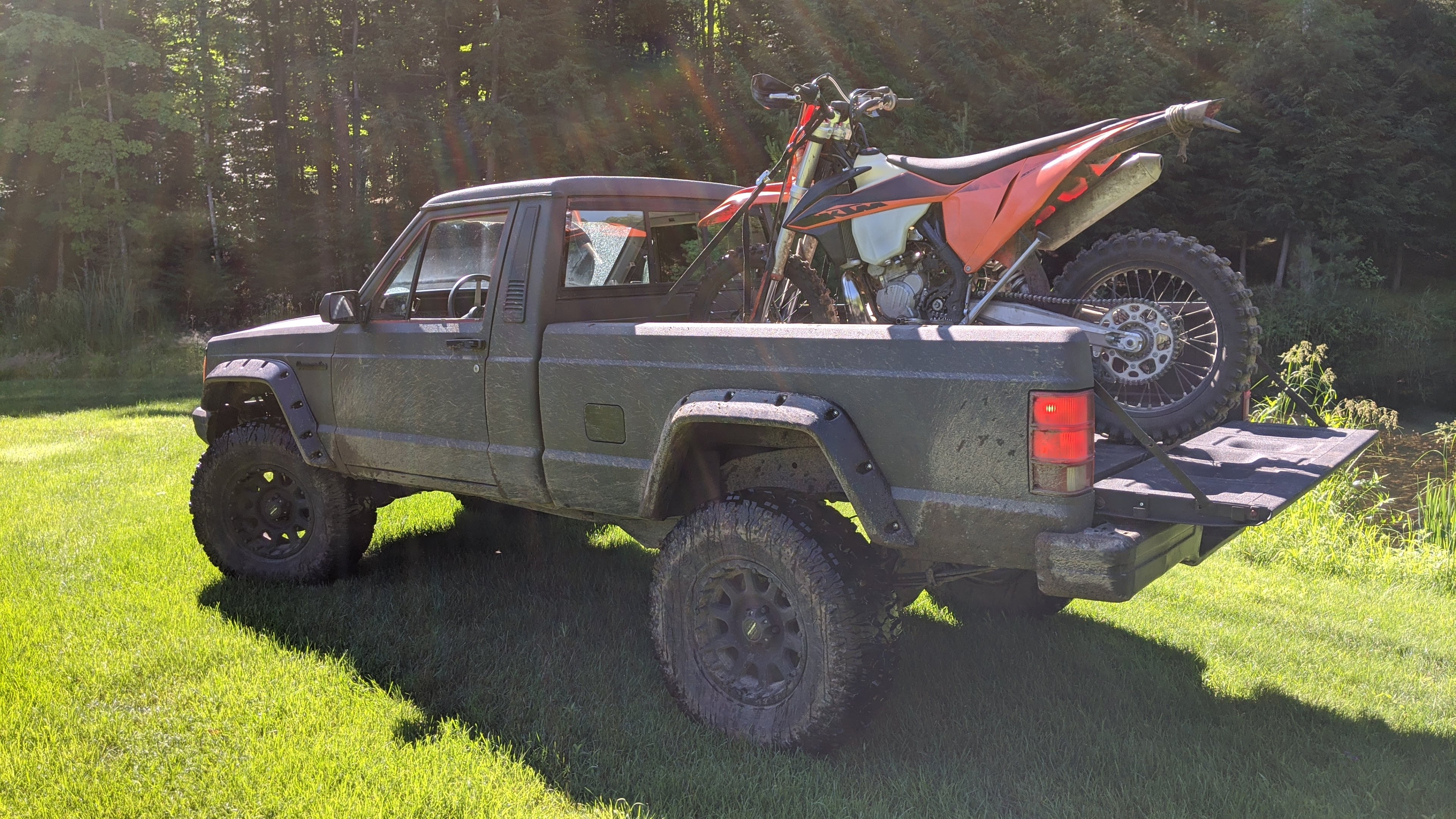

  8. I will post a pic tomorrow of the progress. Hopefully will make the engine mounts and have them welded in. I am using fast forward automotive for my wiring harness. I thought long and hard about modifying the harness myself, but opted for the simplicity that fast forward can offer. He can also make cruise control and all that good stuff work as well. For the transmission, I am using an external slave ax15 out of a newer Cherokee. Hopefully will be able to handle the power being that I am going to be right around 300 ftlbs of torque. I also used the Coty Built adapter to mate the engine and transmission. Looks like a verry high quality part and It fit absolutely perfect. Here is a pic of my truck before the swap and the drivetrain that is going it it.
  9. Just Getting started on a bhw tdi swap. I have gathered a ton of information and wanted to show you step by step what I have done so that if anyone else is interested in doing it they should have the info they need.
