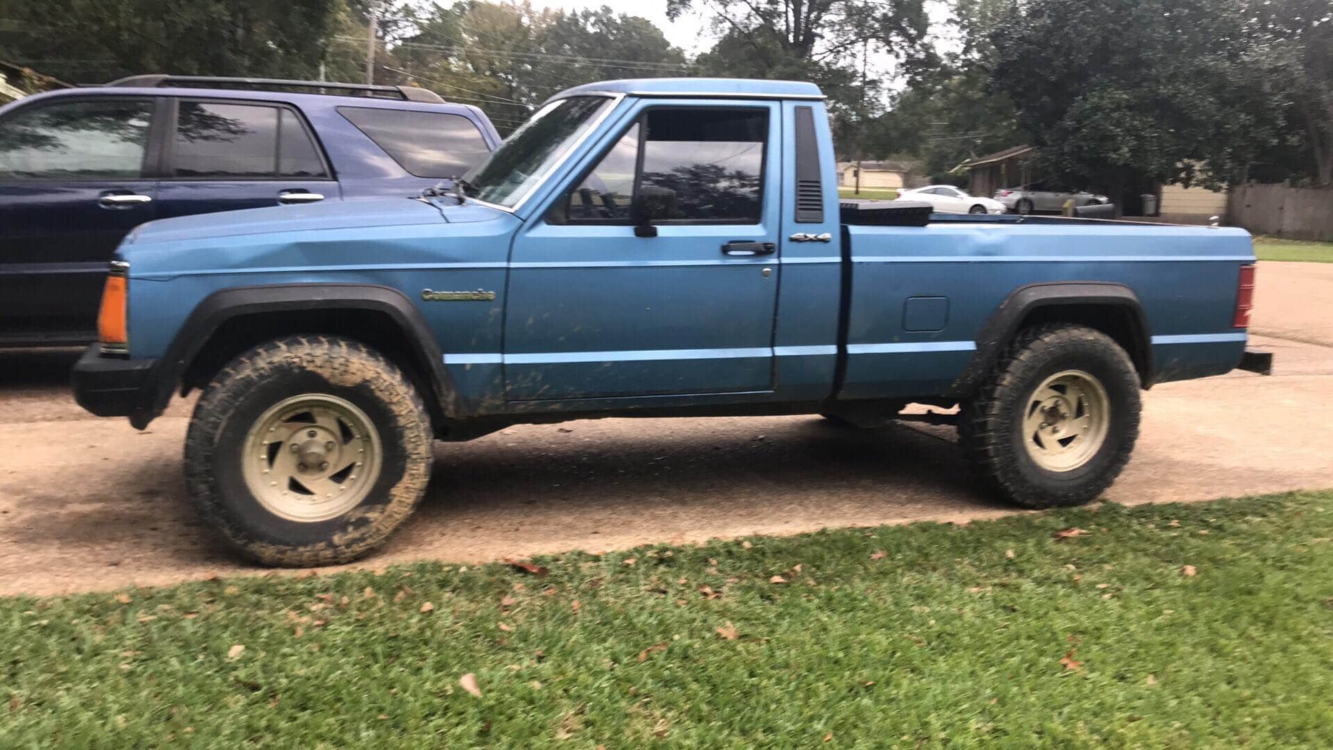

  4. Will do I found some more photos of when it was running and when of some other stuff watch on and Jeep safe
  5. It’s all been kinda straight forward actually. I was surprised that if I took factory Toyota motor mounts and a 1/4 inch plate welded to the frame the motor set in nicely. It’s moved forward so the trans and diff would line up kinda with original floor holes to limit cutting floor board hence reason rad will be in the rear with Electric fans. Other than that the motor fits in the engine like the 4.0 just higher bc Tacoma’s have taller engine bays. And to clear the axle with the oil pan. And i think it will look hella with a Trd super charger mated up in that hole lol That’s why it’s our builds right think out side the box. I could go on for days about what it has taken though bc there is a lot of wires now and I’m trying to use the original dash.

  7. My 88 Comanche short bed. Had the 2.5 renix it took a crap. So I threw in a 5vzfe out a 98 Tacoma driver side drop transfer with asin auto. Dodge rear end out a 03 Dodge Ram. Disk brake rear. Stock Dana up front. Sitting on 35s tons of welding to be redone and actually not just mocking $#!& up soon
