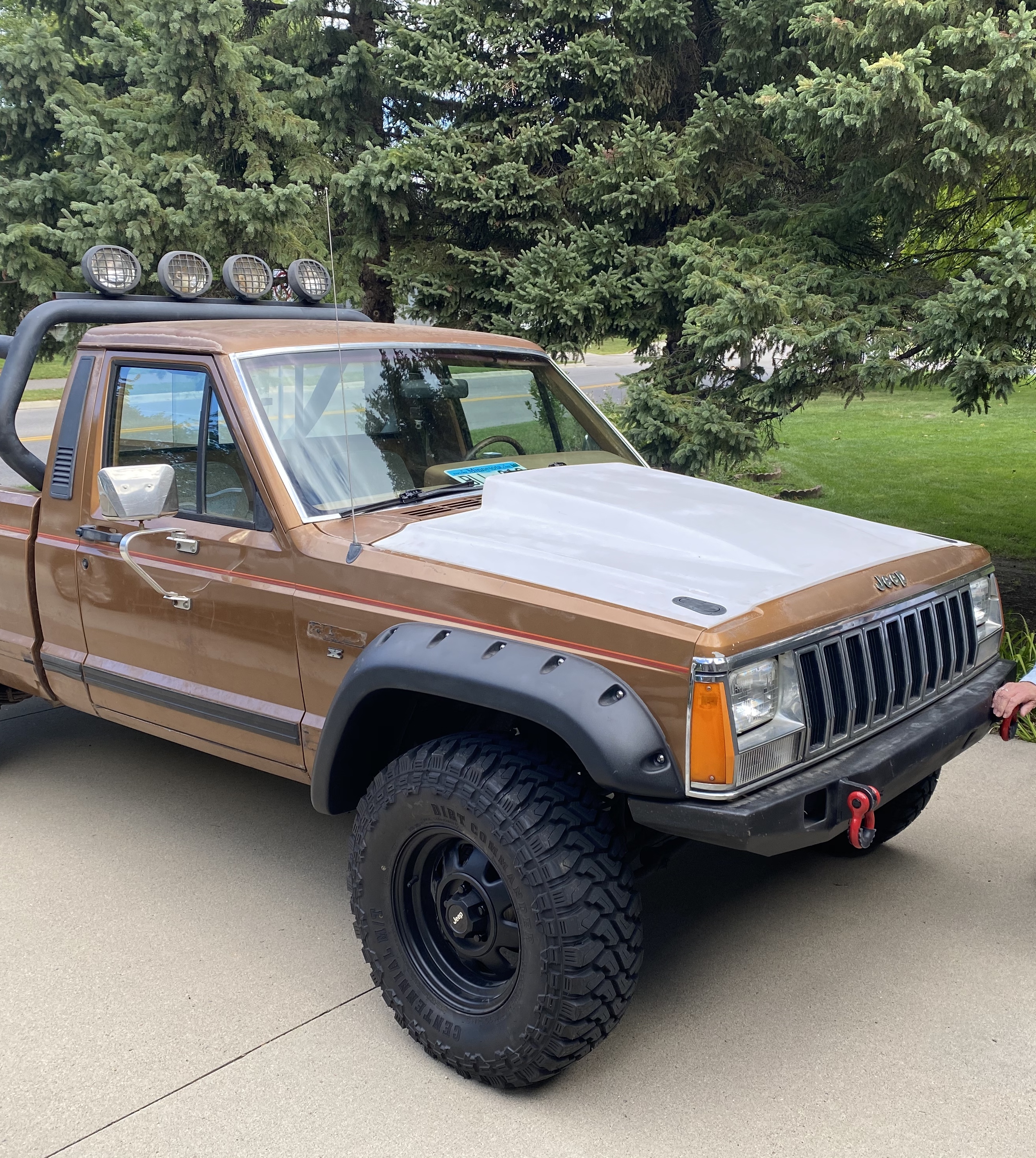

    Here’s my 1986 MJ 4x4. I swapped in a 3.4l stroker v6. It’s got Holley sniper fuel injection, edelbrock 4 barrel intake and headers, MSD 6AL ignition. A fiberglass cowl induction hood, 2” lift with 31’s. I’m the third owner and had it for 25 years.
