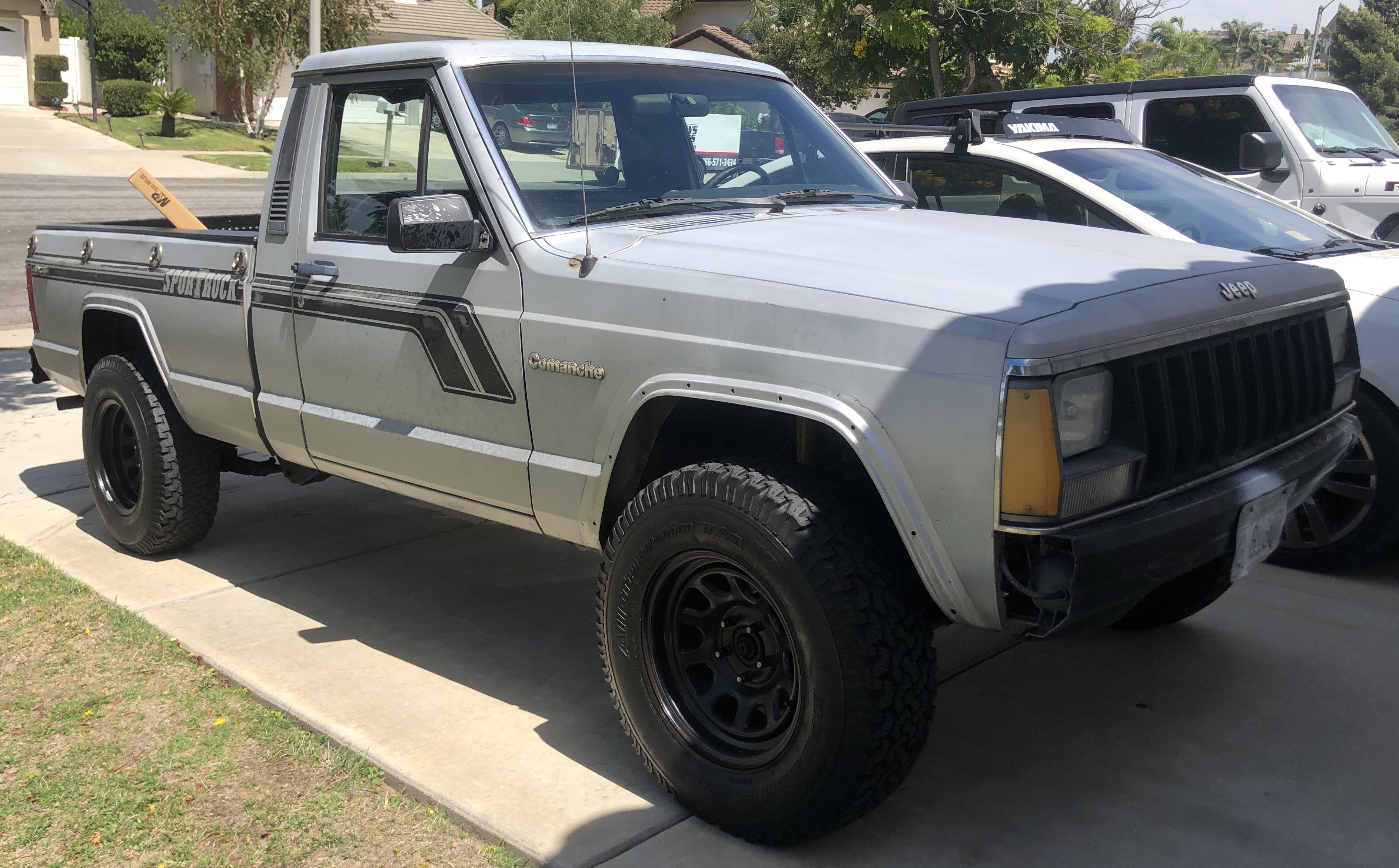

  2. Hello. A couple months back I purchased my 1987 Jeep Comanche. This is going to be my project truck and want to restore it back to original condition. Still learning a lot about this truck and its components. I need to fix the following before making it my daily (especially driving at night): small oil leak but most importantly the dash and running taillights don't work. After I fix that I will work on the interior: sound proofing, new carpet, reupholster bench seat and head liner. Here is what I know about the truck: 215k miles/4.0L/5sp manual/sportuck short bed/4x4 not sure on the axles and was manufactured JUN 1987. I am in California, inland empire area.
