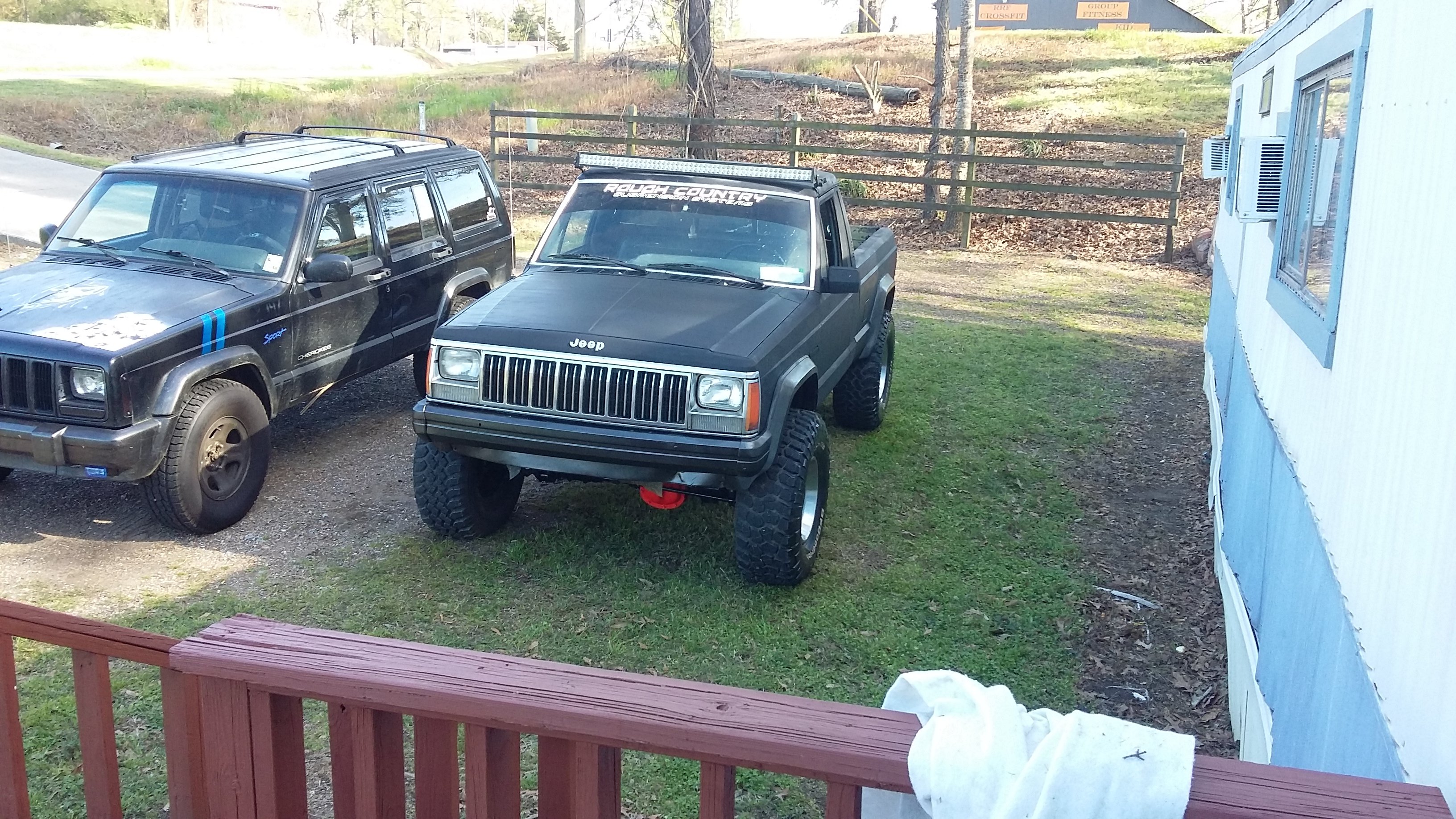

  3. 89 Comanche 4.0L AW4 NP231 Dana 30 / 44 SWB Shreveport, LA 'Merica All door sticker info lost to time I think it was a dark blue metallic color originally (based on doorjambs, but not sure due to multi-colored panel replacement on top of super-oxidized clear coat). Currently black Rustoleum rattle can primer. Had SporTruck decals, not sure if they belonged there. Light bar works left of the glovebox latch. 1 self retaining Dakota taillight. No rust, a few minor dents from PO's play time. Rear bumper MIA, brackets KIA. Interior is a blue vinyl, appears to be all original. Bench seat, column shift, manual windows, sliding back plexiglass, and 3 rifle gun rack (that was a factory option, right?) When I got this heifer it had 33x12.50r15s (15x8 F/ 15x9 R), 4.5" coil springs / leaf springs , shocks, tube LCAs, factory track bar, death wobble, and a full-time EGR valve (6" vac hose valve to manifold lol) I added a RC drop track bar and dual steering stabilizers, Rustys steering box braces, ZJ tierod, Alloy ball joints, working master and wheel cylinders, a loud @$$ flowmaster, and a P/S pump or 10 She was passed around a lot before it ended up in my hands (traded straight up for 2000 Saturn SL). Still working on her, but got really curious if the 4.0 auto 4wd D44 combo was factory
