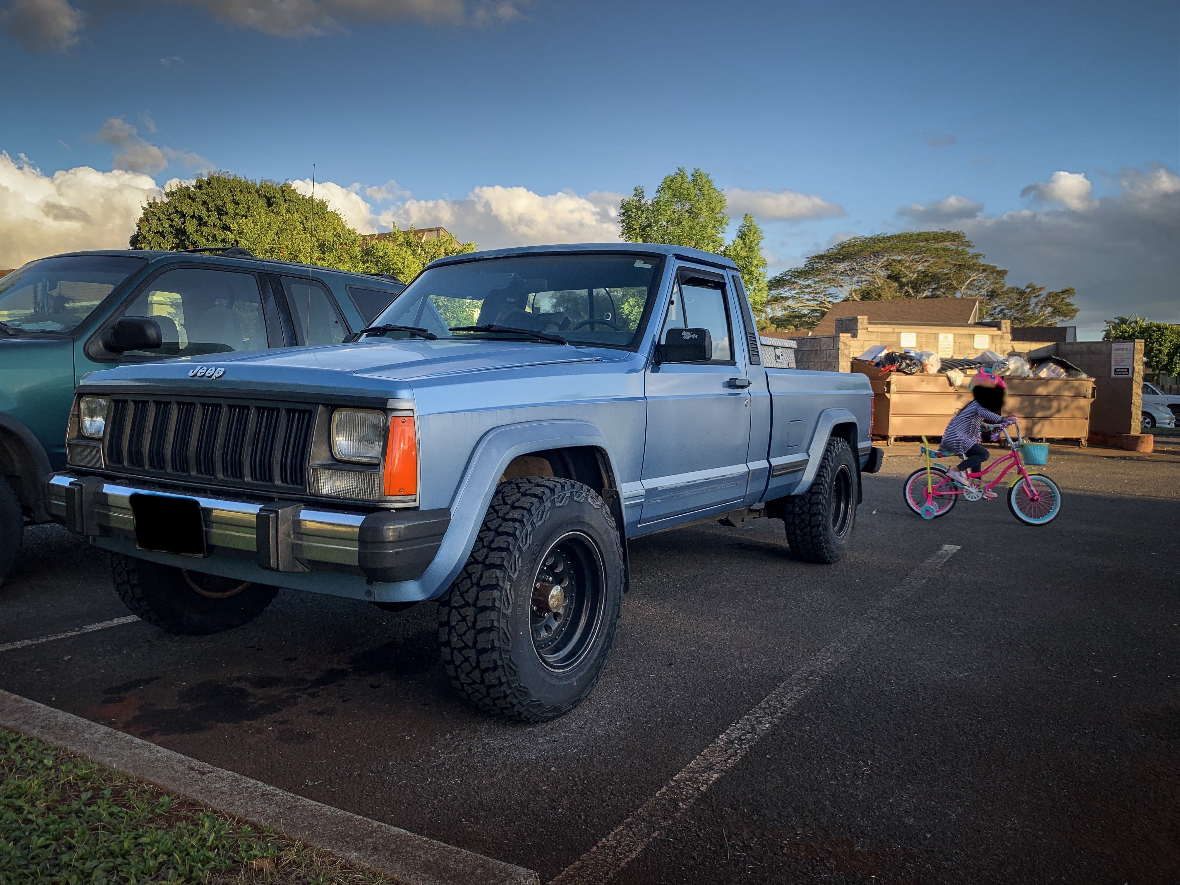

  1. Thank you guys for your responses and advice. I looked under the truck today and noticed my bushings are going bad(I think. Theyre dry and cracking as well as the holes are more of an oval than a circle) same with leafs. The leafs in the leaf pack aren’t exactly parallel with each other, the shims are super worn out and the overload leaf is flush with the rest of the springs and last but not least my drivers side shackle seems to be a little bit bent and leaning towards drivers side. So I figure if I replace all of that and go with the 4/1’s(budget is a priority for this job) what front coils should I get to match? Oe spring, oe spring and spacer or aftermarket spring ? I really don’t want the truck to have rake after doing the leaf swap and really don't want a rough ride.
  2. I see now exactly what your talking about. My drive shaft is dead straight. I figured if I'm removing the hardware I figure I might as well just get some new springs in there. I was looking at General Springs and see they have two different options (4/1 and 3/2 military wrap/metric pack) which one will give a smoother ride? I’d prefer a smoother less stiff ride over strength. This is my DD and will rarely get taken off road and when I do it’s on a mellow dirt trail with some bumps and hills.
  3. Thank you for the info. How does the truck ride with the MT’s? Are they stiffer than the regular ones? Is there a big difference in ride quality? Was looking at General Springs and saw they have both regular ones and MTs. Its the original springs and axle. I’ll get around to adding them specs soon. Thanks for the info and picture. Really appreciate it.
  4. What are some possible causes or what should I be looking for that would cause the axle to scoot over to the drivers side? The truck has never been in an accident and has never be wheeled exept for a few gravel roads.
  5. I have tried searching for days now but can’t find anything about this subject. I bought new tires the other day and had them installed professionally and after sitting back and looking at the new look of the truck I noticed my axle seemed off center. I’ve never noticed it before so it very well could have been there prior. The tires stick out of the flares on the drivers side and sits right under the flares on passenger. It favors the drivers side about 3/4” or so. I talked with a couple people about it and they had two different responses. One mechanic said I need to get new leaf springs and change bushings and the other said since my drive shaft is straight I shouldn’t worry about it and maybe change springs(since they’re original and 31yrs old) within the year but doing that isn’t going to change the way the axle sits under the truck. Has anyone else who has a manche with d44 in rear noticed this? Is it normal or is there a fix? I see it now every time I look at the rear and is frustrating not knowing it this is normal or not.
