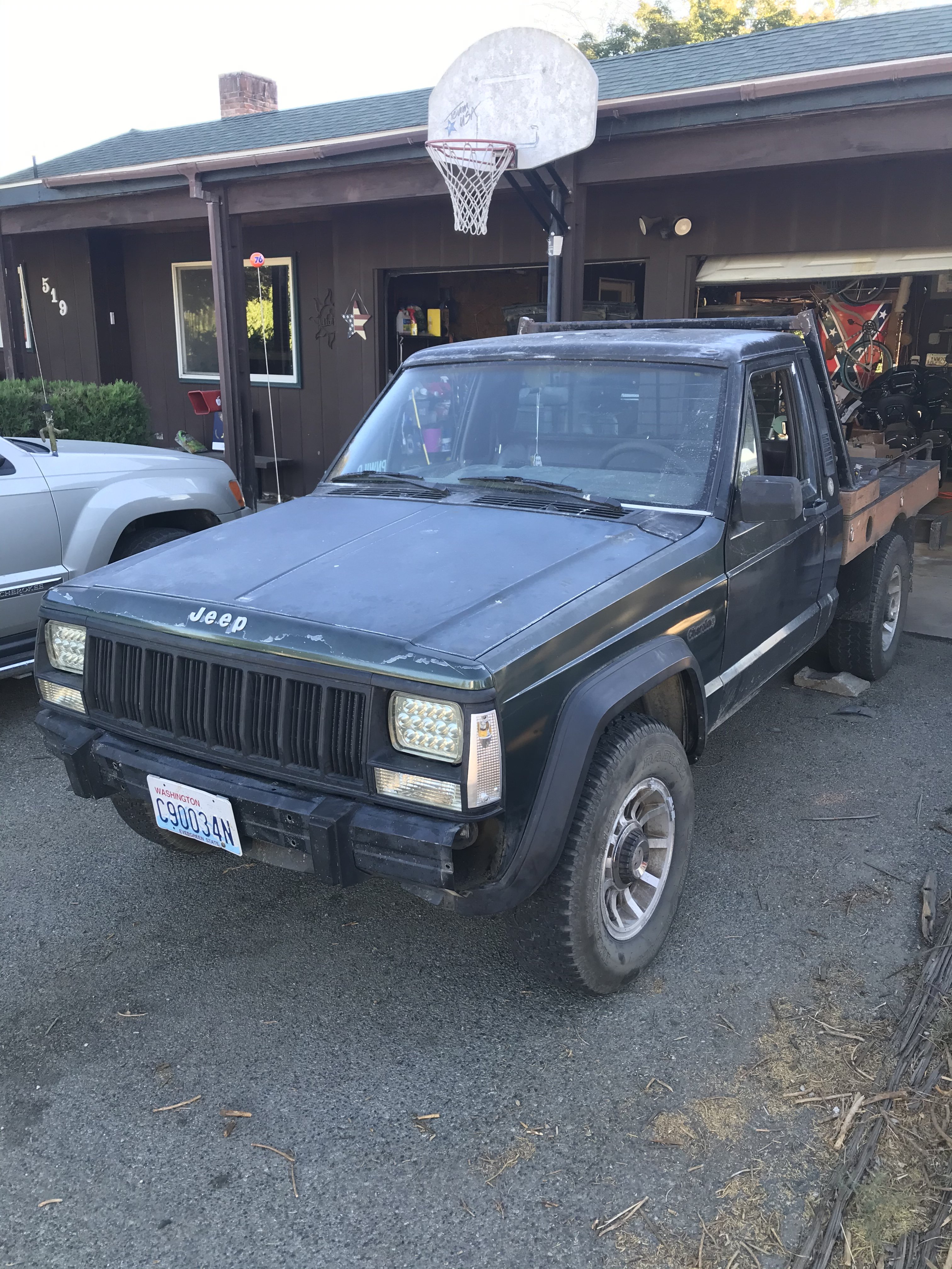

  4. Hey guys, I have a fuel delivery problemo with my 87 Comanche. Went to start it and nothing happened after several seconds of cranking, then smoke came from under the hood. I cannot locate where the smoke came from, for there is no signs of anything burnt. I am no longer getting power to the fuel pump, I only have 3 relays to swap out with one another and have tried them in all in all different positions. I hear something of a fusible link but cannot locate it. Any suggestions?
