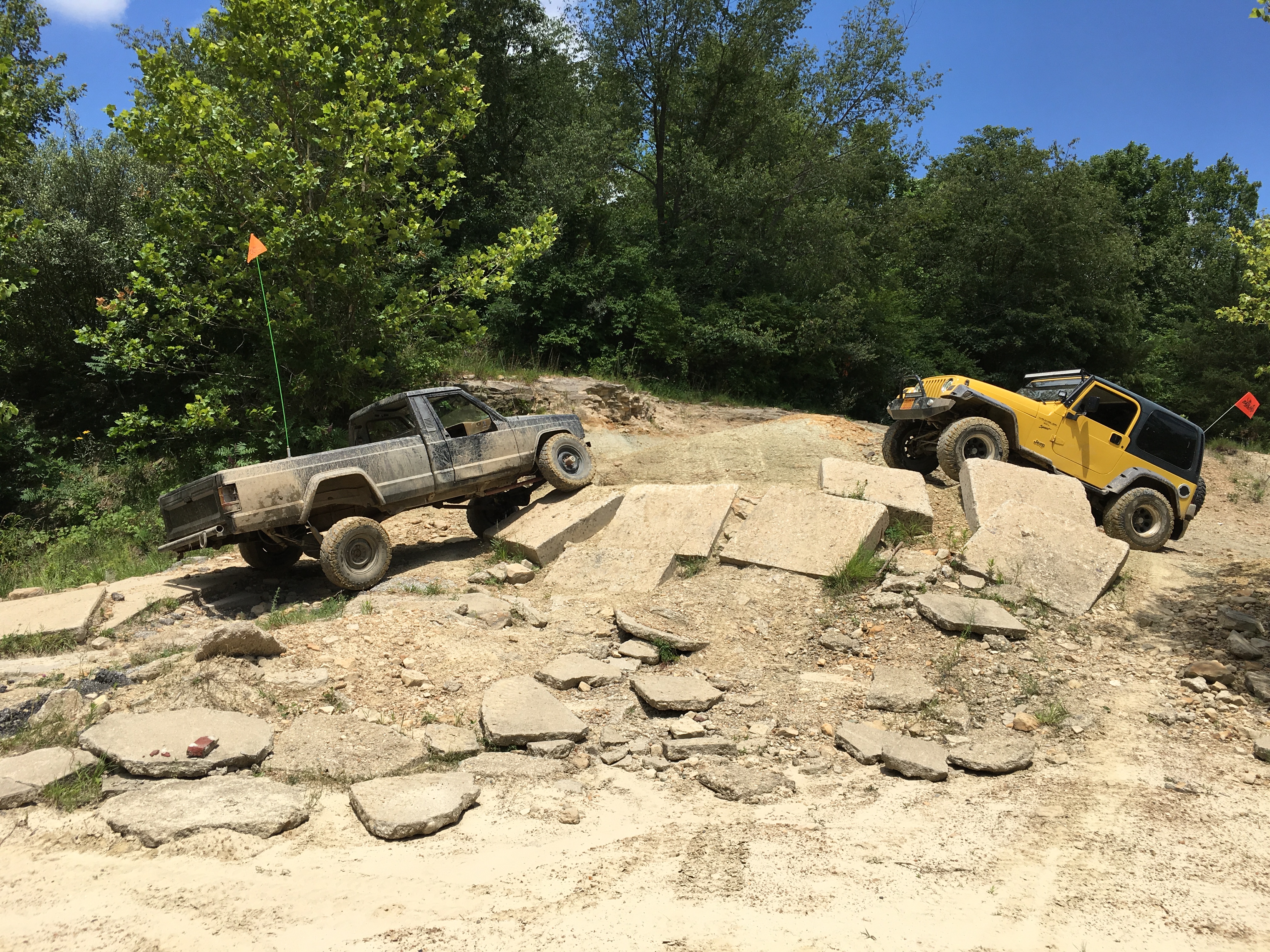

  1. Time for an update!!! I was tired of it being brown and thought that black and red would be a nice change. I got my axles, suspension, and steering all ready to go. I have done some more work on it since these pictures were taken. Once I get a few more things done I will do another update. I am waiting for my winch to arrive and then I will finish my front bumper. I am also wanting to make a new air intake system and make things a little more water tight.

  3. It is hard to tell from this picture, but one of the first things I did was take a Ford 9 in rear axle and swap out the Dana 35. It looks like doing the spring over the axle gave me somewhere around 4.5 inches of lift. I also put a door back on the driver's side.
