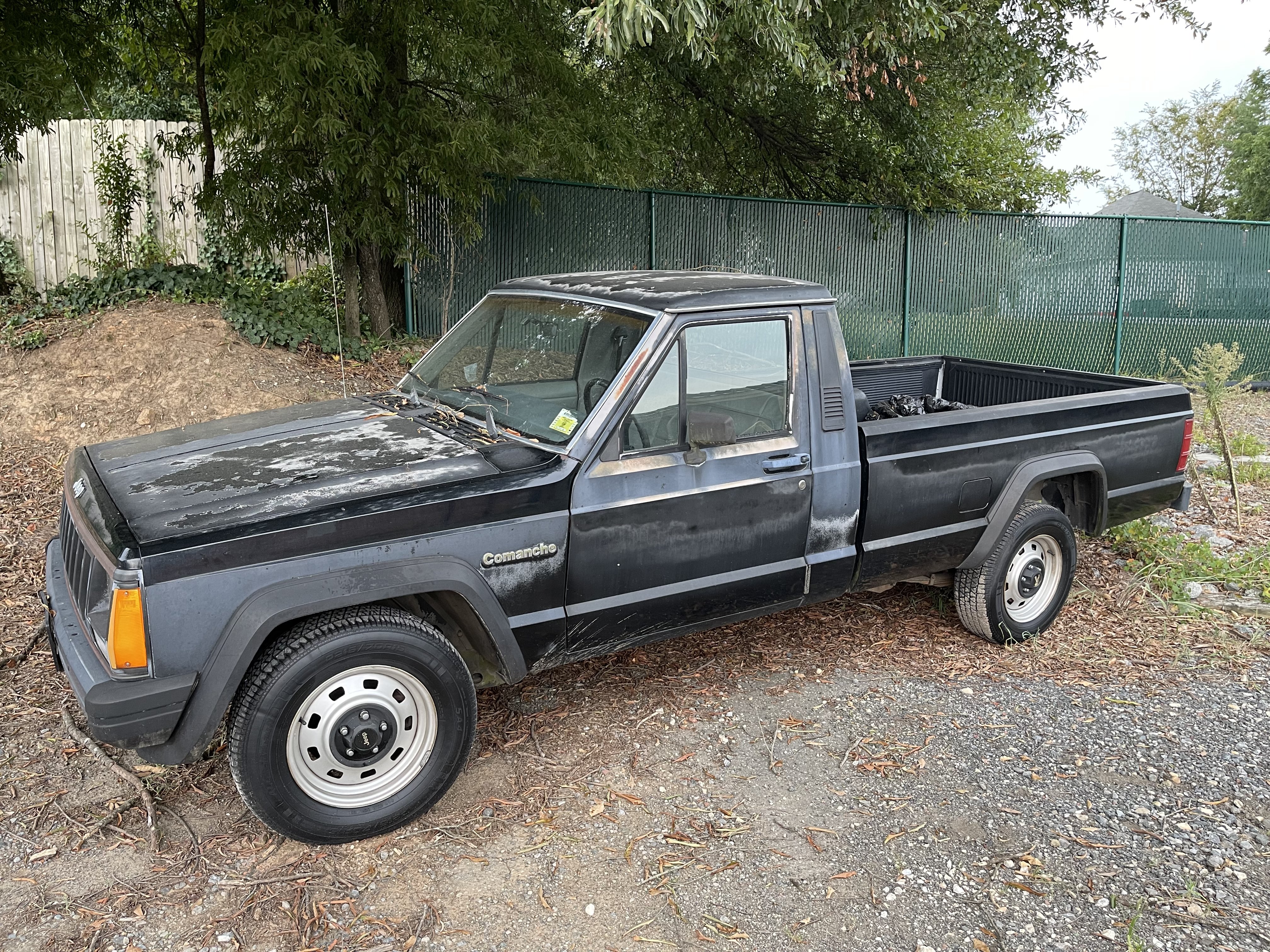

  7. I’ve wanted to get one of these for the last several years, and just recently started looking around on various sites. This one is lacking 4WD and the AX15 transmission, but it’s a low mileage, rust-free, dent-free survivor so I went ahead and picked it up. So far, I’ve been able to purchase a later model AX15 2WD transmission, and today I ordered the General Spring 5/2 leaf springs with military wrap, JKS adjustable coil spacers and Skyjacker shocks. My goal is increased payload, better handling and better ground clearance. I’m planning to go with 31” tires and will adjust the front coils just enough to accommodate the larger tires. Tomorrow I’m picking up a set of the OEM turbine style wheels with center caps. I’ve seen different reports re: increased height with the General Springs. I’m hoping for 2”-2.5” in the rear and just enough up front to accommodate the larger tires. At 2”-3” of lift up front, will I need longer sway bar links or longer brake lines? Any other items I need to consider with just 2”-3” of lift? Is so, can anyone provide a source or part numbers? Thanks! Shane
