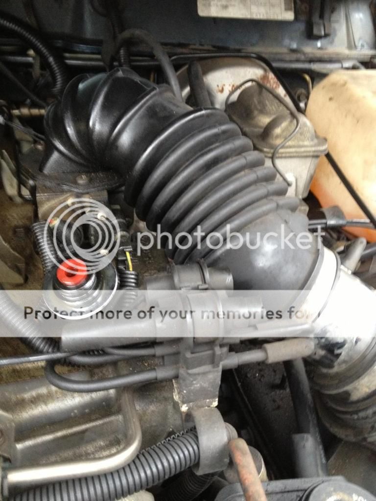

Truck came with this hose cut off when first purchased, totally forgot about it until I was working on the valve cover yesterday. What's it for?
Posted Image
Talking about the one in front that's been cut.

Crankcase ventilation, it runs from the valve cover to the airbox as you can see here:
Posted Image
Looks like you have a non-stock airbox though and the previous owner just cut it off. Is there a plug in the valve cover opening?

I put in the cold-air, but the hose was already cut. :dunno:
No, there was a small air filter in the vent hole. Should I plug it, or try and run an OE airbox again? (Or mod it into the cold-air?)

As the PCV sucks out blowby gasses from inside the crank case, there needs to be a filtered source of outside air to enter the crank case so there is neither a vacuum or pressure inside. That hose going to the air cleaner is the filtered sourse of air to enter the valve cover to replace what is being sucked out.

As long as the filter is a good fit in the hole in the valve cover, so that the air that gets sucked in through the Crank Case Vent (CCV) system is filtered, it's alright to leave it like that. It's hard to find parts store ones that are a good fit though, usually. So if you want to leave it like that, clean it up and put some RTV around the hole and make sure all air going in is going to be filtered. Otherwise, hook it back up to the airbox like factory.
Here's the gotcha though... a lot of times people remove that tube and put an aftermarket filter there because their air box filter is getting soaked with oil. Usually what happens is then the whole engine bay gets soaked in oil, because their CCV system is not working right. This should not happen on a properly working system, even IF the motor has blowby. The fumes get pushed out the front valve cover hole and the airbox air filter gets soaked on a stock system when the small hole in the REAR grommet in the valve cover gets clogged. It's important that this small hole is not clogged and is connected to manifold vacuum. This manifold vacuum draws oil fumes from the rear grommet in the valve cover into the intake to be burned by combustion. The small vacuum also draws fresh air in through the front hole on the valve cover, which is why it's important that this front hole is filtered.

You're using confusing terms here, because these motors do not have a standard "PCV valve" like most motors. They have a "Crank Case Ventilation" system, or CCV system. No PCV valve needed. The rear grommet on the valve cover needs to be hooked directly to the intake manifold so that vacuum is applied to it with the motor running... but you can't run just any old grommet in there, it needs to be the one with the small 2.2 or 2.6 millimeter opening, otherwise it will create a huge vacuum leak and your engine will idle super high. Go to any parts store that carries Dorman products and get Dorman part number 46005, which is a kit with the right grommet and the tube that goes to the intake manifold.
The front grommet is the fresh air inlet, no PCV valve goes here or anywhere. This simply needs to be a filtered fresh air source so that when the vacuum sucks the fumes out the rear, the motor can take in fresh air to replace. You can put a grommet in it with a properly fitting small air filter, or you can get Dorman part numbers 46003 and 46004 which is the complete vaccum tube assembly for the front and includes the grommet for the front hole in the valve cover and has the entire tube that replaces the part that's cut in your original picture. This tube would then connect to the airbox for a filtered fresh air source. Either one works, the 2nd option is the way the factory did it, and if you have emissions inspections, probably the best way to fix it.
