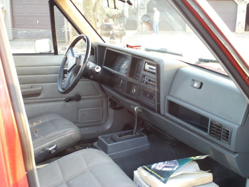

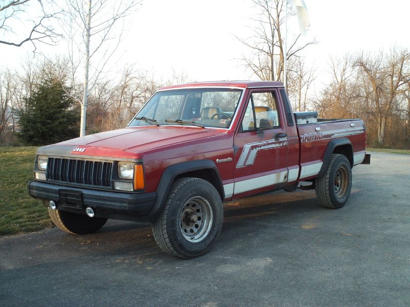

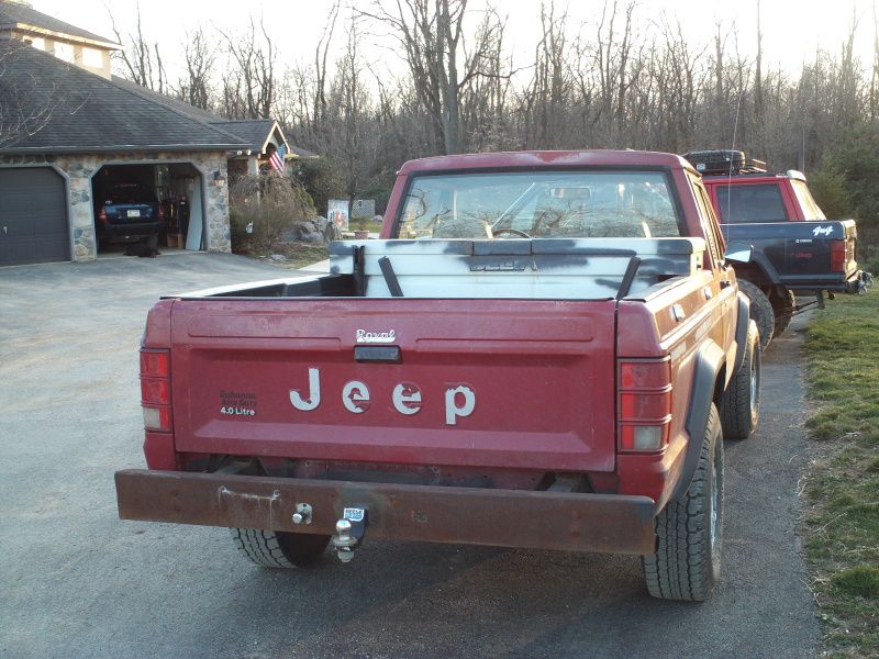

Hey guys, Well over the past couple years Ive caught this addiction to MJs as many of us have, but till now all my Jeeps have been 4wd...Untill this little guy was put up for sale. I had been in contact with the owner a few times over the past year+ and when he decided he wanted a Land Rover, I was the first person he asked when he was ready to part with the MJ. A few conversations and $500 later I got my 5th Comanche :D
Overall its a very strong truck still, some minor body rust but a clean frame and the Drivers floor was already replaced as well. Its an 88 SWB 176k miles 4.0/AW4/D44. Lots of new parts installed over the past year and with just alittle TLC this truck will have no problem becoming a reliable DD. My plans are simply to bring this little sucker back a bit of its glory and then probably DD it down the road....for $500 and and MJ in this shape, i wasnt about to pass it up {SMILIES_PATH}/jamminz.gif
Posted Image

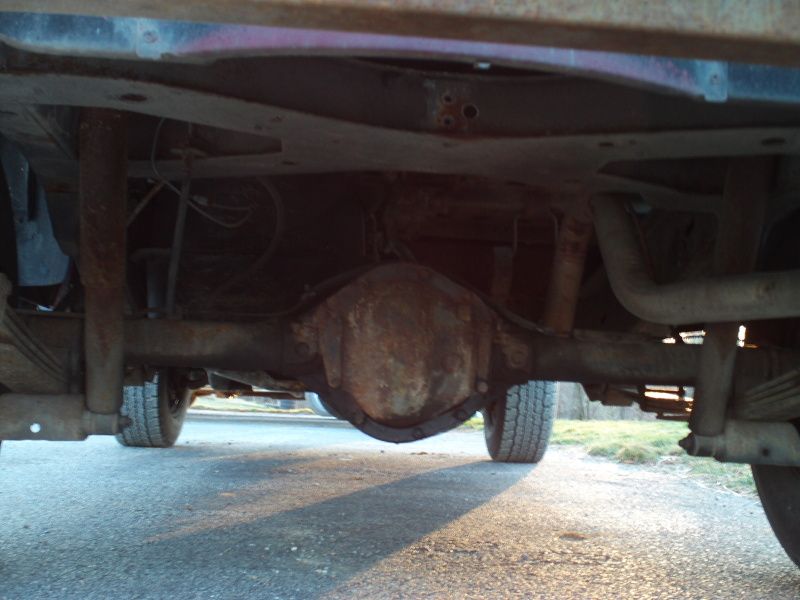

:yes: D44 with trac-lok
Posted Image
Interior mostly there, also has a sunroof!  8)

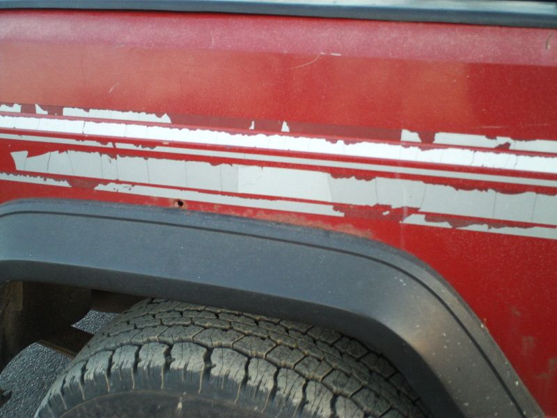

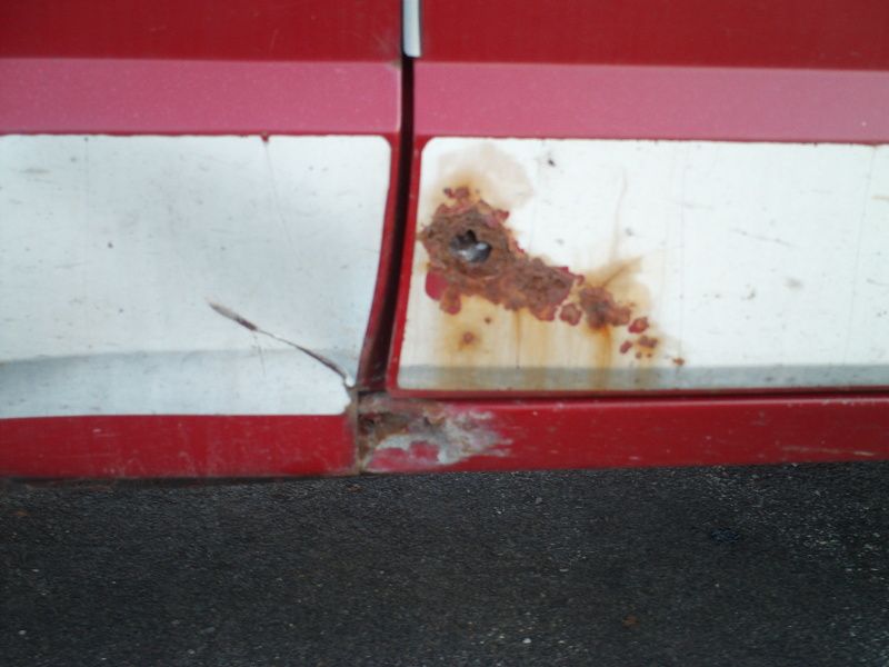

Minor body rust...
Posted Image
Posted Image
