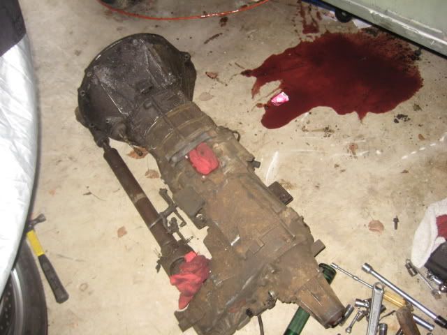

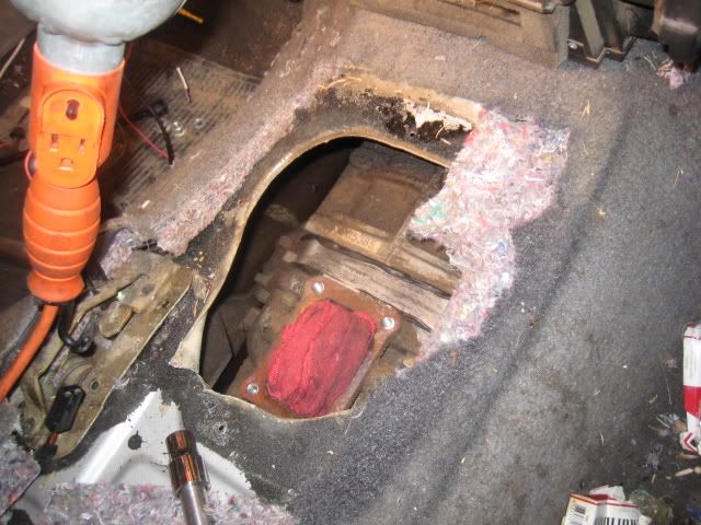

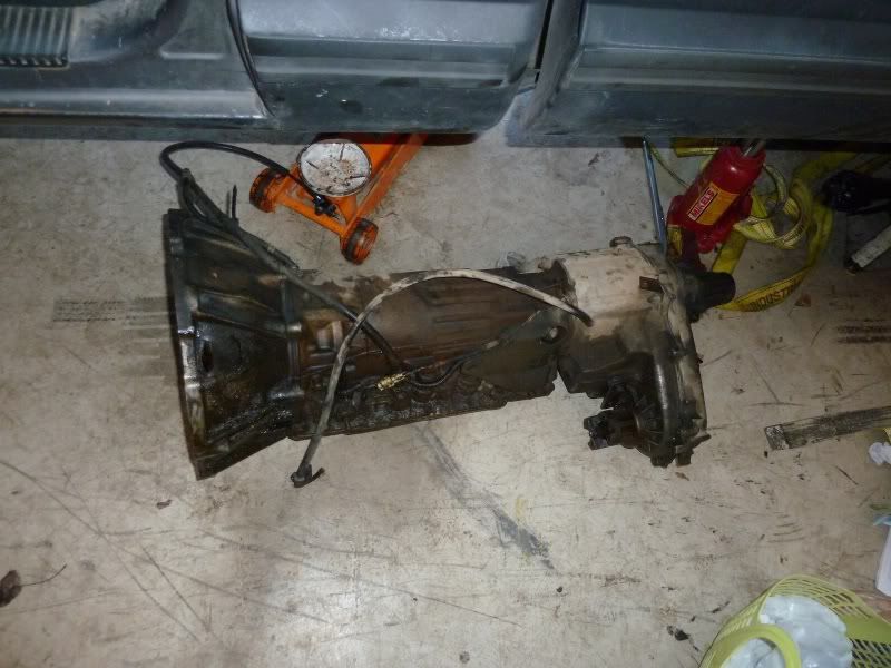

Posted 22 January 2011 - 06:35 PM
Column has to go...

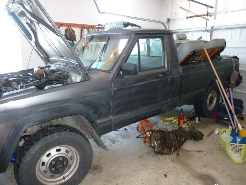

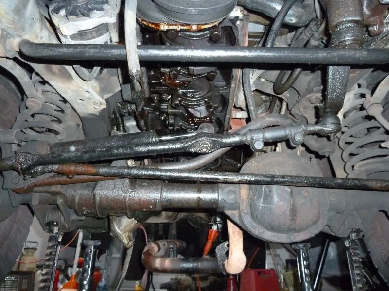

Posted Image
That wasn't so bad...
Posted Image
Posted Image
Tranny out... That was a job. Stupid hidden bolt!
Posted Image
Posted Image
Posted Image

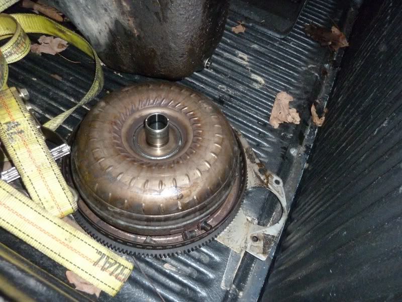

Well, since the change deleted all of Sunday's posts, I'll redo... :fs1:

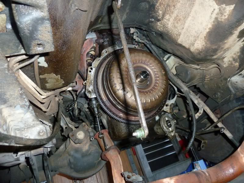

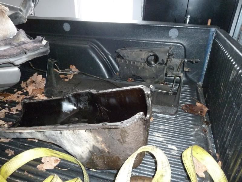

Removed the torque converter and flywheel...
Posted Image
Posted Image
Removed the front skid plate and the oil pan...
Posted Image
Posted Image
That's it for now. :clapping:

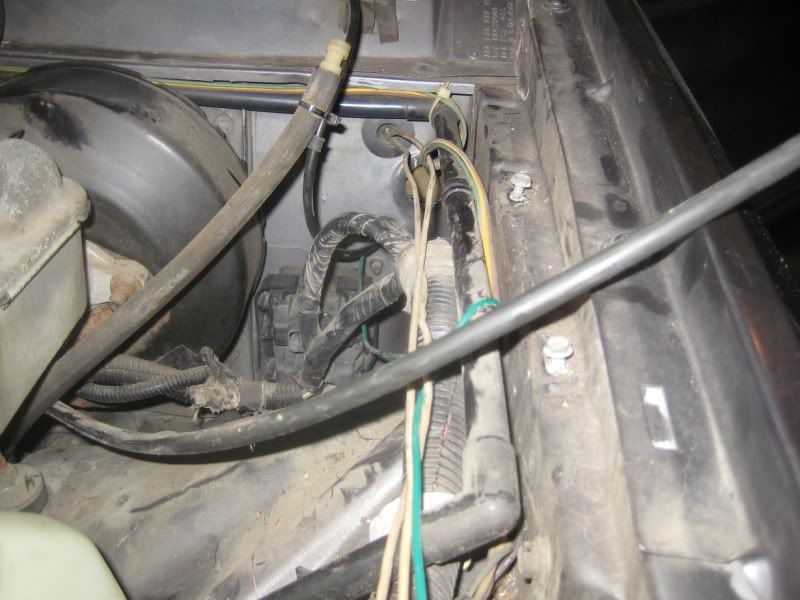

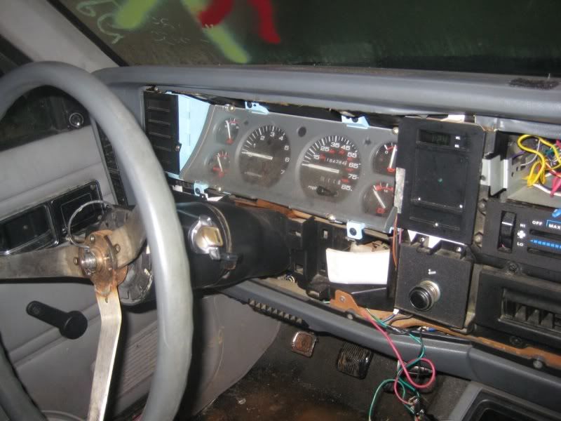

Posted Image

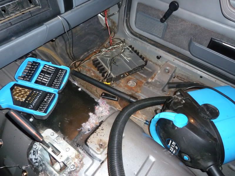

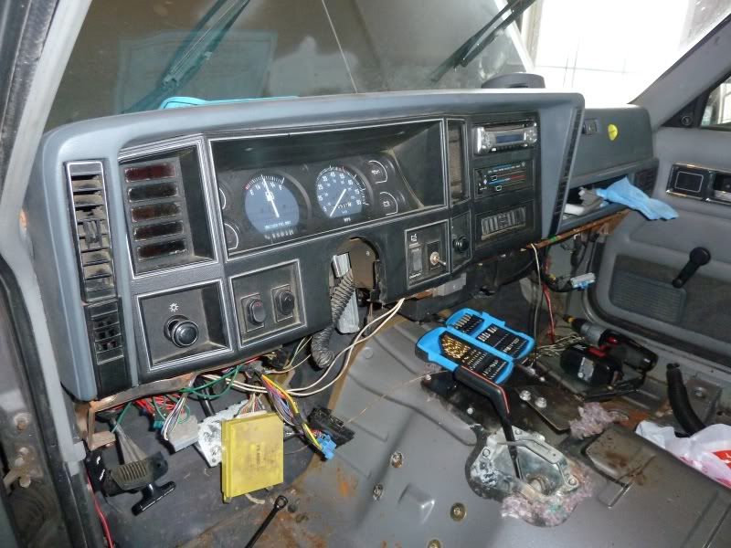

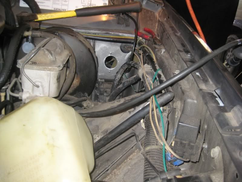

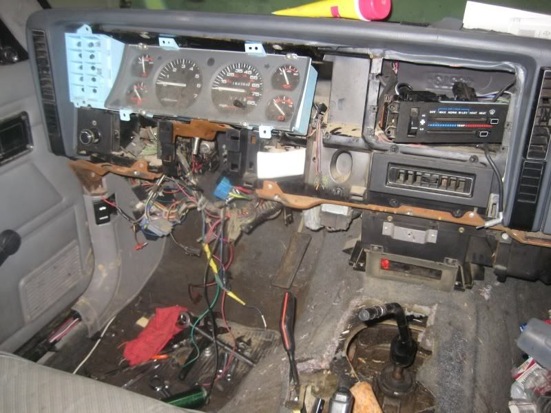

Then I took out the console, glove compartment cover, clock, loosened the heater controls and gauge cluster.
Tomorrow I start on the tranny or the steering column, or both. :shake:
Posted Image

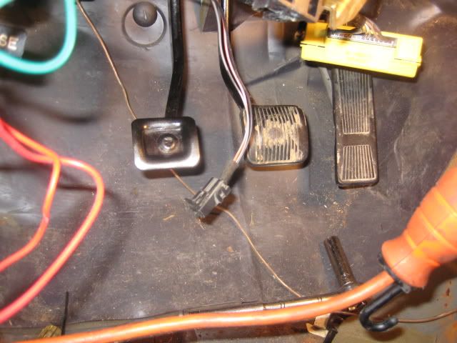

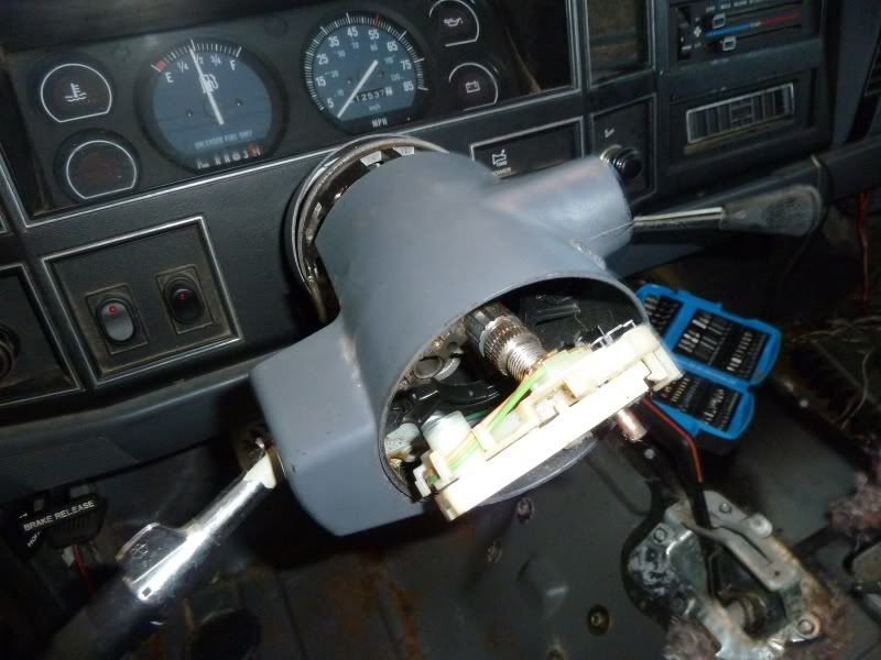

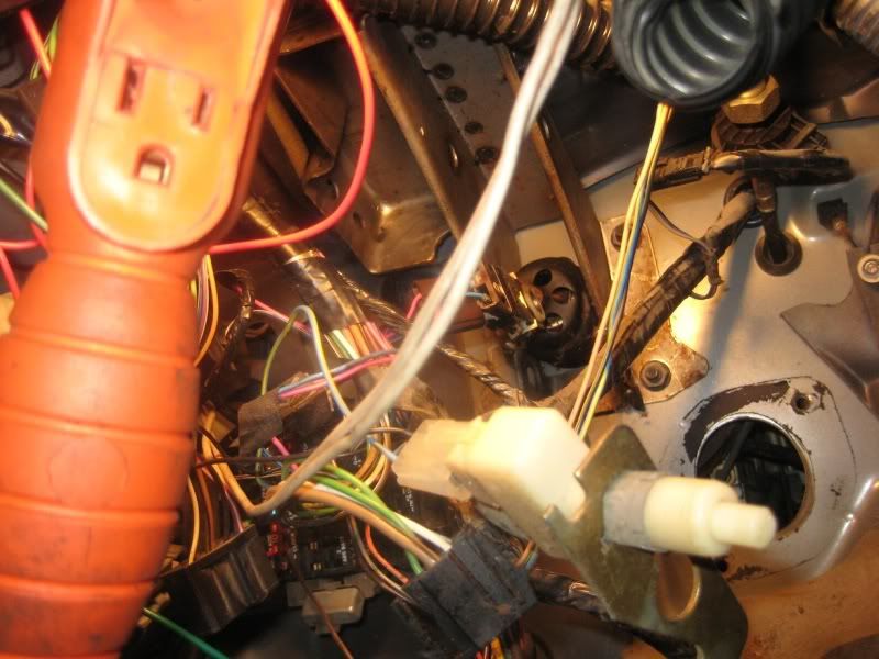

Today I removed the steering column and pedal assembly from both vehicles.
Posted ImagePosted Image
Posted Image
What the? :dunno: At least we know where it originated.
Posted Image
Now I have to take this from the donor:
Posted Image
And put it in this spot on the truck:
Posted Image
Slowly but surely. :wrench:

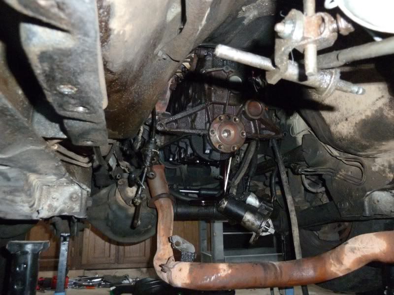

Posted 20 February 2011 - 09:29 PM
Well, got the transmission out of the donor.
:thumbsup:
Posted Image
Posted Image
Posted Image
Posted Image
:wrench:

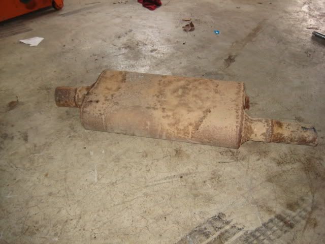

And looky here, the donor had a flowmaster.
:banana: Posted Image
Donor also has a lift kit of some sort and some aluminum lower control arms.
Might have to move those over too. Not sure how much lift. Doesn't seem like much.
I'll try to get the flywheel and clutch out of the donor this week.
Then I've got to start buying some stuff. (New Clutch, slave cylinder, etc.)
