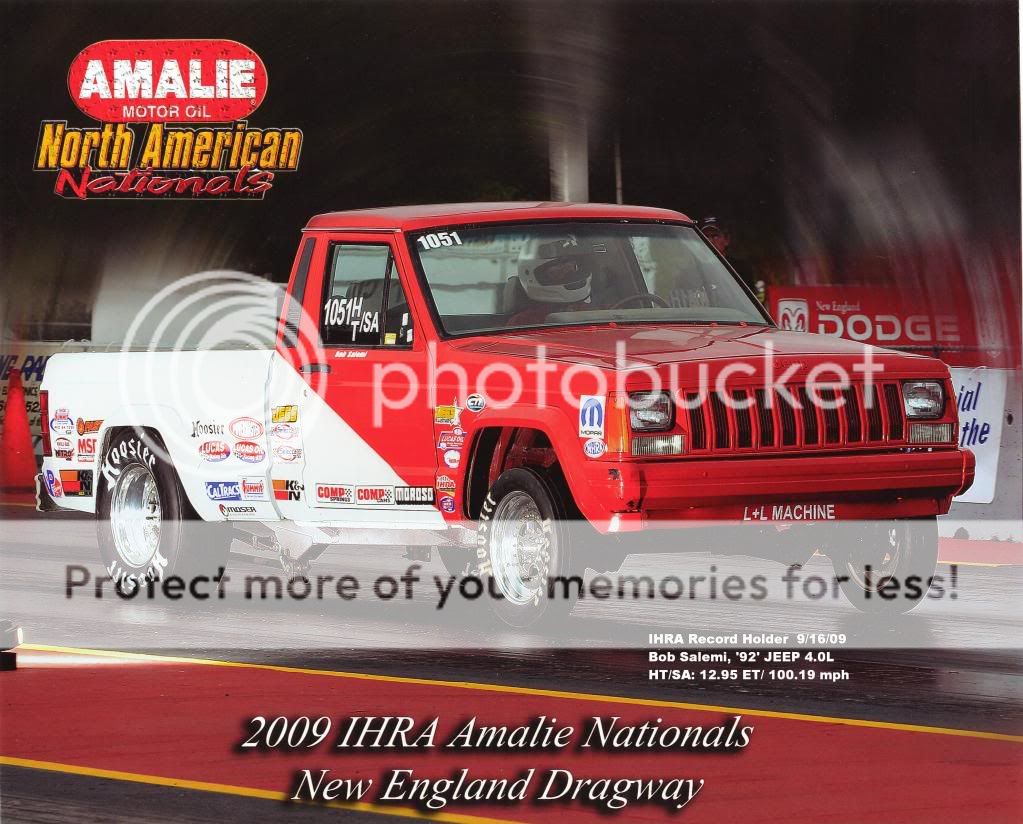

OK Bob did build an early stroker, but that is not what is in his race truck. Here are some details
Attached is a pix of the Comanche - runs HT/SA in IHRA and R/SA in NHRA.
3230 lbs (18 lbs per HP) )60 over comes to 249cu in.
Running stock eliminator requires stock compression,head, manifold and T-body.
stock size valves, any valve job. cam limited to stock lift - .439" with any
valve spring. Exhaust header is 1 3/4X37" 6 into 1 collector 10" long. Trans
is a 904 with 2.74 low gearset and 5.38 gears with 30X9 Hoosier radial.
running the old FAST fuel injection (has been the biggest learning
experience.)
8 or 9 years ago ( when Bob did hid first stroker) Only Hesco and Clifford were producing strokers, and they charged about $7,500 for them. The details on how to do it were not widely known. Bob experimented on his own and made one for about $2,000. It is still running and has about 75,000 miles on it now.
But back to the drag truck, a basically stock comanche that runs in the 12's is impressive.

Bob's first stroker was (and probably still is) in his XJ daily driver. I used to visit him regularly when he was building both the truck and the engine. It was a stroker. Unless he has changed the engine, it is still a stroker. The truck was a shell he rescued from a junkyard in Massachusetts. Nobody wanted to buy it from him for the $100 he had paid for it, so he decided (since the pro dragster he had been crewing on had been sold) to build it into a drag truck. I watched the transformation take place, and I was in the shop when he flow tested the head after he had cc'd it. In fact, the original tailgate off the truck is leaning against my garage.
The engine he had in it then was a stroker. If the engine now isn't ... he has swapped engines.
And back when Bob did his first stroker, in the XJ, Hesco and Clifford were not the only ones selling strokers. There was a company in Maryland, that has since gone under. And there was another company, that's still around but the name of which I can't remember.
And then there was the strokers' e-group, where all the guys who were doing their own hung out and exchanged information. We knew about the VAM engines and pistons back then. There was an American living in Mexico, for example, who was hot on tracking down a source for them. Sadly, he died of a heart attack just when it appeared he was close to scoring. Dino Savva was a member of that group, too. He built his stroker in Saudi Arabia. I don't think he used anything from Hesco or Clifford.
