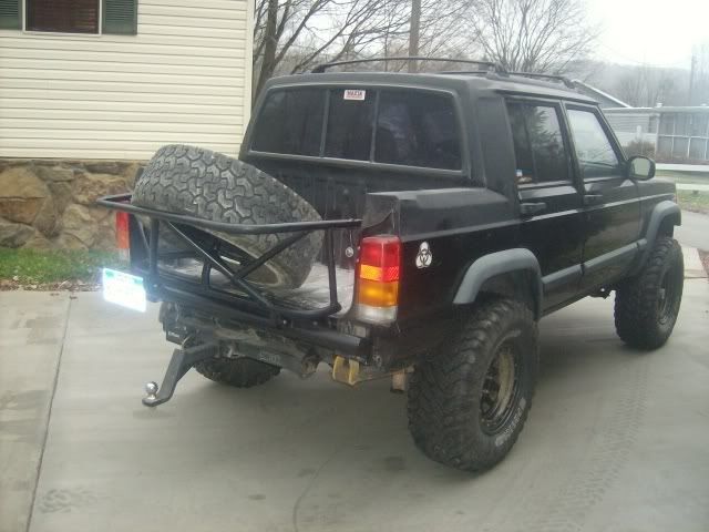

Why not just take an XJ and chop the back and add a comanche tailgate? You could even add some material to the cherokee to resemble a comanche bed. Seems easier than completely building a mix of the two.

Something like this maybe?:
Posted Image
Or?
Posted Image
Some XJs and an 86 MJ.

The guy that had that done is getting a new one torn into him by pirate4x4. He did not pay the guy who did it, then lied saying he was in the hospital, now he just will not talk. Before the thread got closed he had singles pages on every tranny/ghey site you could imagine, and he is being drug around on every car forum out there. On top of all that, he came on another forum and started claiming that he was the one who did all the work, then changed his story and said that he paid and paypal must have screwed it up.
Wow, did not know that. I don't want to bring that drama here, i was just showing a good chopped XJ. Richard, they guy who did the work is a stand-up guy.
